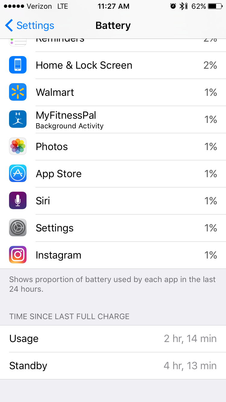

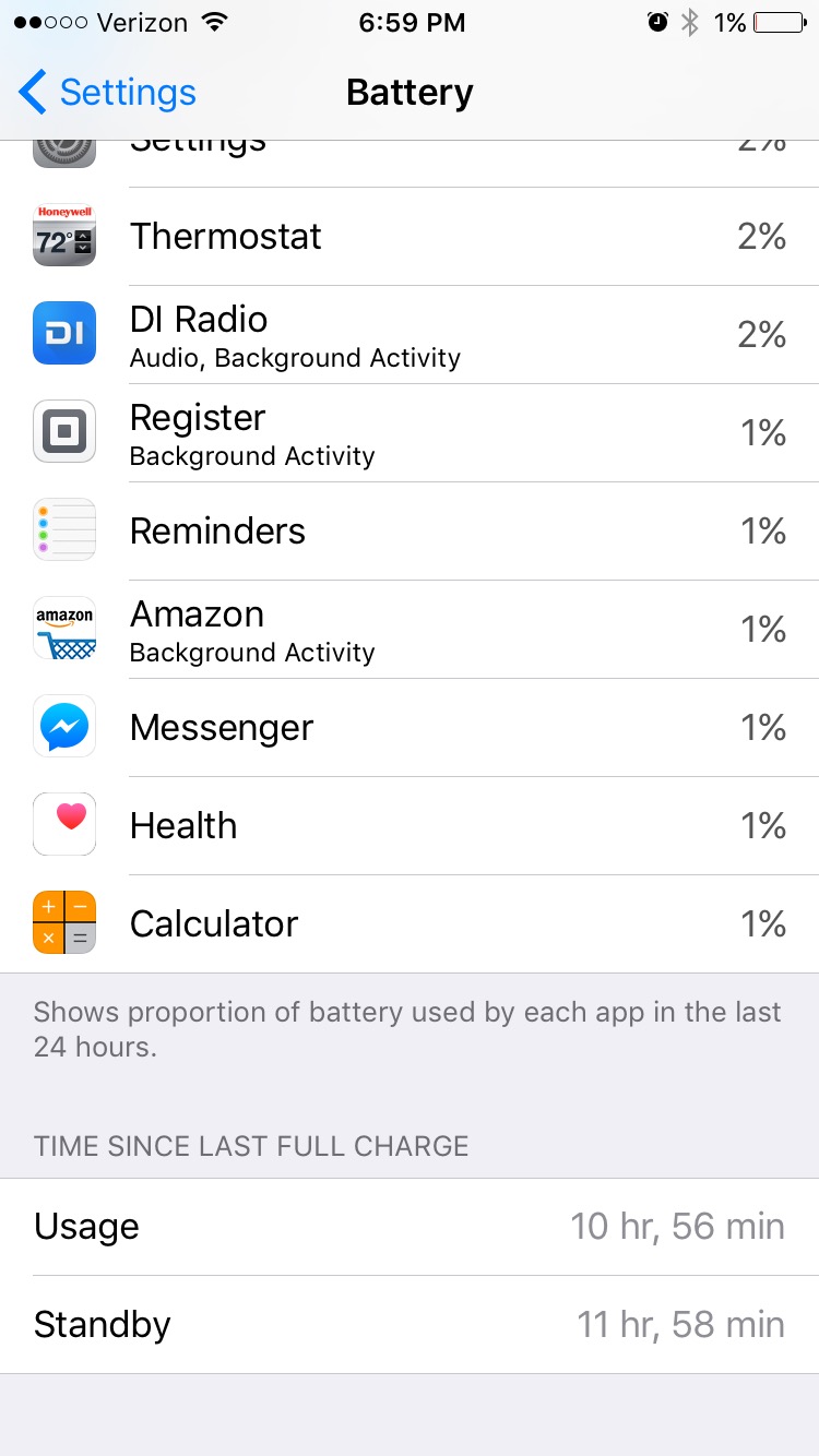

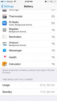

Guys I know that there are multiple threads about "Battery Life" however, "we" are all using a 6s and not 6s plus from what I see. Could you please share your battery usage with screenshots just to compare how your phones are holding up? Because I am either not really amazed by my battery life on my 6s.

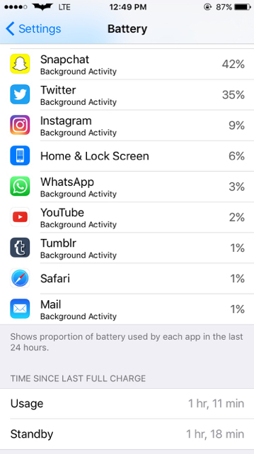

Here you go. Be noted that I'm jailbroken, and this phones battery has degraded a bit.
Reactions: Vanilla35
Thank you very much!! Until now it looks good in my opinion. And I think that the best is when you post ur battery usage later on in the day, like under 50% or around 30% and under. Like this it is better to keep a track of it 🙂
