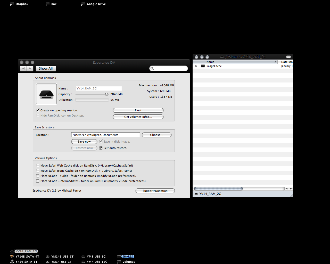

But with the ram I now have in my 2.3DC I DO have ram to spare and I've allocated 2GB of it to a ram disk.
Usable as a scratch disk by Photoshop and a recovery data location for InDesign it's helped speed things up a bit.
I'm using the system Prefpane called "Esperance DV". It's been around for a while but this is the first time I've really been able to leverage it.
And the best thing about it is that it will reload the ram disk on reboot. I don't have to remember.
Esperance DV can be found here.

Esperance can only give you a maximum of 2GB. The other app can go as high as you have RAM for. However, Esperance will reload the ram drive when you relogin. The other app will not.
It's more important to me that my ram disk reload so I didn't really try to get the other app working.
As I mentioned though, Esperance has been around for a LONG time. I was using it at a certain point with the G5 here at work (when it was my Mac). And I've had it on my old TiBook when it was alive as well. It's only just now that I have 2GB to spare to really start using it.
Last little bit. It works under Yosemite on the Mac Pro at work. The prefpane will crash System Preferences when you create the ram disk, but the ram disk IS created and will return when you relogin (if you have it set that way). I thought that was interesting.

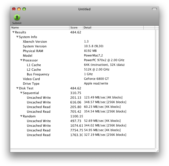

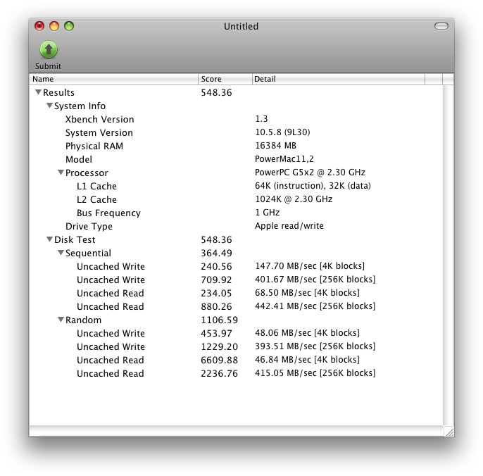

Out of curiosity, I ran Xbench on the Ram Disk. Here are the real-world results of pushing filesystem data around in memory.
Power Mac G5 Dual 2.0Ghz (7,2) 8GB PC3200 (400Mhz) DDR RAM
Copying TenFourFox FP3 across to the RamDisk results in a total launch time of 5 seconds (down from 11 seconds on the 7200rpm HDD)
Power Mac G5 DualCore 2.3Ghz (11,2) 16GB PC4200 (533Mhz) DDR2 RAM
Copying TenFourFox FP3 across to the RamDisk results in a total launch time of 4 seconds (down from 9 seconds on the 7200rpm HDD)
At 400MB+ per second read/write speed, this would also make a nice scratch disk for Photoshop or Final Cut Pro.
