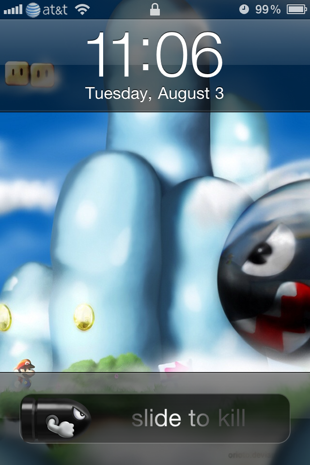

So I thought I would show you.

How'd you do it? Share! Did you do it via SSH? And if so, where did you find the files?
The slider file is called bottombarknobgray. It's in /System/Library/PrivateFrameworks/TelephonyUI.framework. That's also the location of the other colored sliders, too.

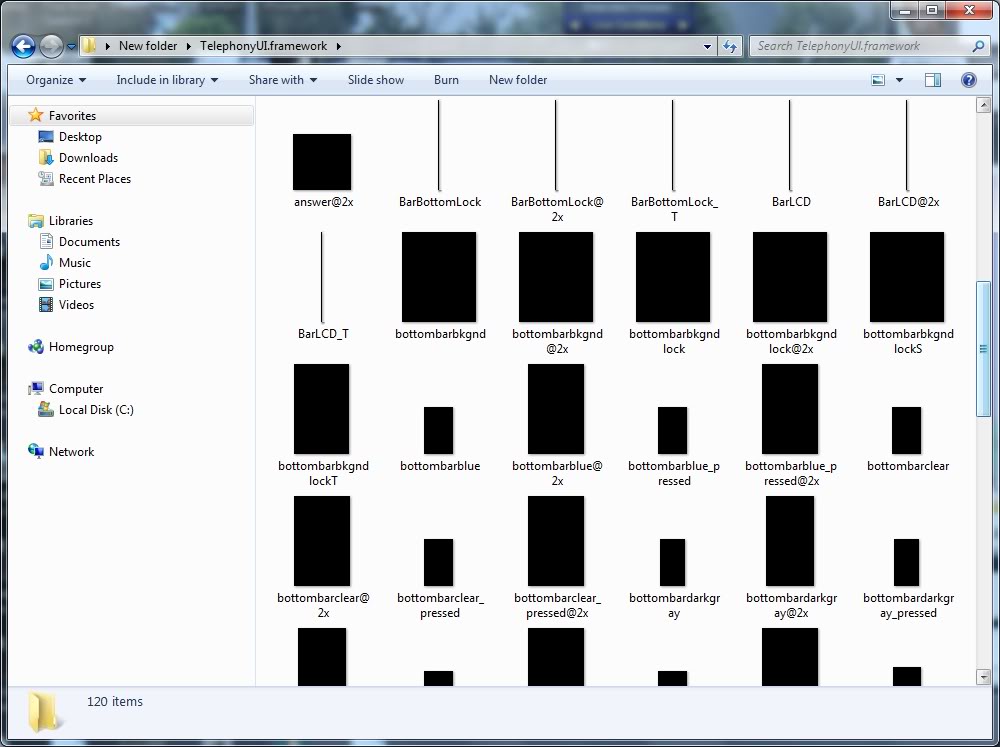

i'm trying to change mine, but i'm having a problem. when i try to open the images through WinSCP {pc}, they don't show up at all. and when i copy the folder to my desktop to back them up, or view them, they are just black.....here's what i mean:
i want to replace it with a slider theme {through SSH} that isn't working on my iphone 4 through winterboard, that i used to use on my 3gs......
