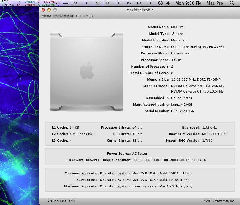

What did you replace? What year MP?
Sorry, sometimes I assume people know this routine with 1,1's. I have a document with the history of my Pro, it isn't complete but has most of the steps I've taken.
Original Specs:
1,1 Mac Pro (2006)
4GB RAM
Dual 5150's dual core@2.66Ghz (total 4 cores)
HDD:
2) 128GB SSD's in a RAID0 array (added upon delivery)
250GB 7200 RPM
Video Card:
NVIDIA GeForce 7300 GT
Geek Bench 2 (32bit)
1st Run 5514 (Orig. Spec.)
2nd Run 5579 (RAM upgrade)
3rd Run 5587 (RAM upgrade)
4th Run 5601 (RAM upgrade)
Power Fractal
37.004 GFlops
PS CS5 test from Macrumors:
Post #1027
Link
27 seconds
Updated to:
2,1 Mac Pro (netka's, firmware updater)
12GB RAM
2) 128GB SSD's in a RAID0 array (Crucial M4's)
1) 250GB 7200 RPM (22,000 hrs) (original shipped drive)
1) 500GB 7200 RPM (45,000 hrs) (imported from wintel drive farm on network)
1) 1TB 7200 RPM (35,000 hrs) (imported from wintel drive farm on network)
1) 2TB 7200 RPM SATAIII (500 hrs) (recent purchase)
Video Card:
Nvidia GeForce GT 430
20.7 seconds Shaved almost 7 seconds!!
1st Run 10657
Power Fractal
84.540 GFlops
My Pro is used as a file server as well at anytime up to three other devices can be connected to it.
All tests were performed while these connections were open with file sharing running.

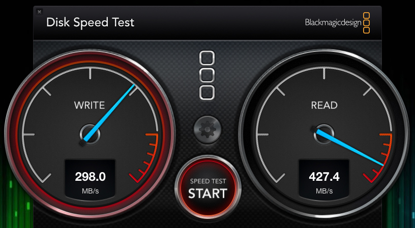

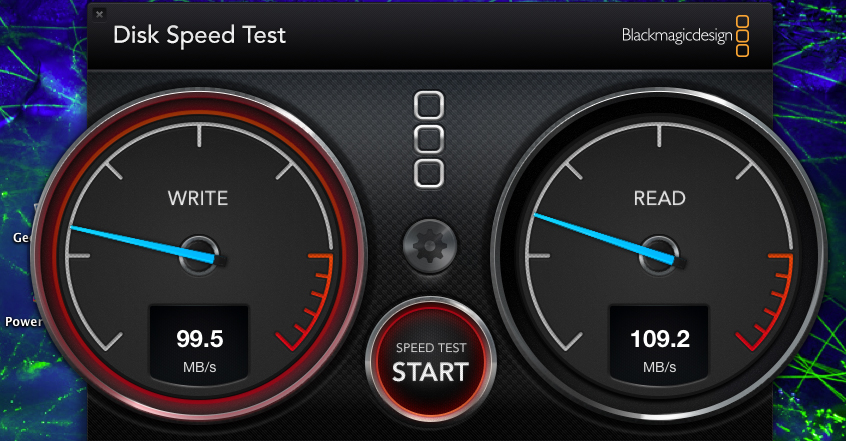

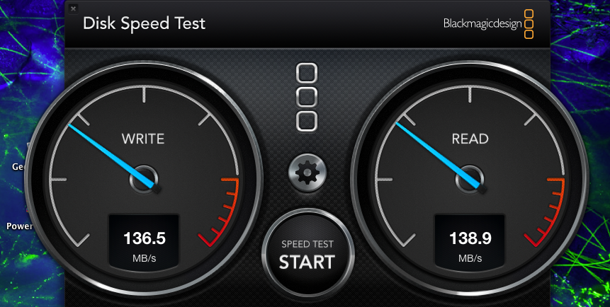

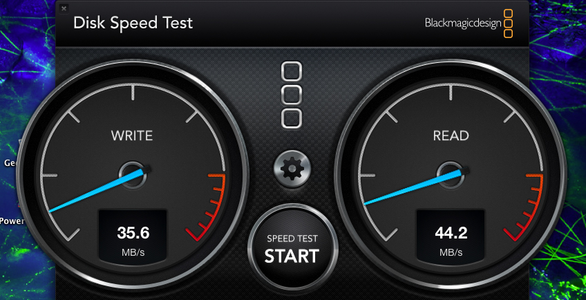

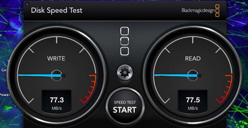

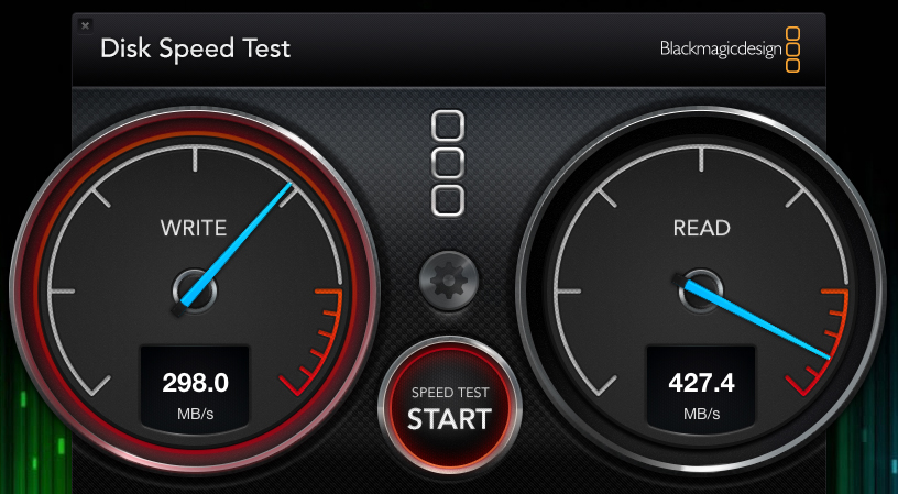

I did some drive speed tests here are the screen shots. When I was doing the 2TB drive time machine decided it was time for a back up, so it is off by about 40 to 50 MB/s. Hovering over each tells about the drive.
The SSD is 2 drives in a RAID0

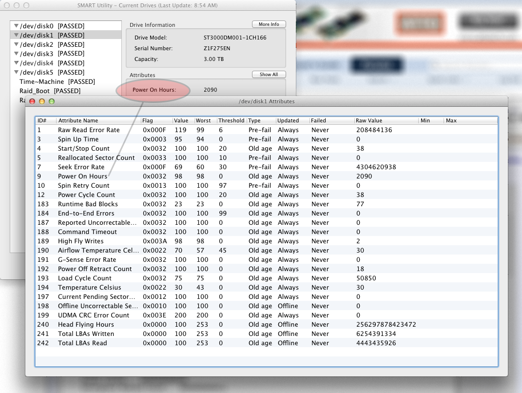

How do you tell how many hours the drives have been running for?
They record it themselves. You can read it with a S.M.A.R.T. reader. You can see it displayed either via the information button in DiskUtility or via something like SMART Utility. SMART isn't supposedly supported over USB tho so if it's a USB drive you'll need a special reader which claims to support SMART.

And here's what SMART Utility looks like:
