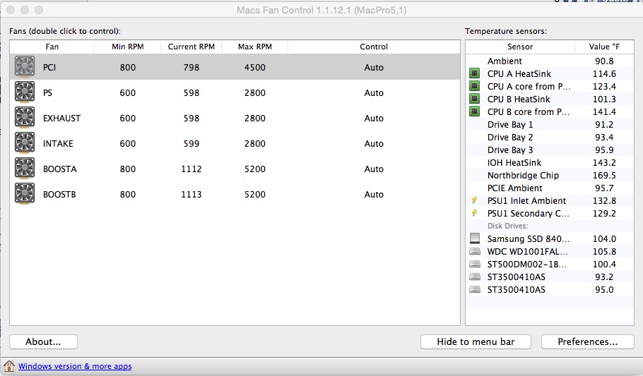

Lou do you run any type of fan monitoring software on your mac pro. If so at what rpm does your pcie expansion fan run at? because with a unflashed gtx 780 in a mac pro the pcie fans go to about 1500 wich is loud and much louder than the normal idle of 800rpm with a gtx 120 or 5770 in a 5.1 12 core.
^^^^Pic attached. My GTX is a Gigabyte 3 fan model. They call it WINDFORCE 3X, and I believe it's an excellent cooling solution.
Lou
Though I don't have the Nvidia 780GTX, I am using a flashed EVGA 770GTX 4g gram card. I don't use any fan control software and just rely on the machine's default fan settings. The PCIe fan runs very quiet with no fan noise from the card and from the Mac Pro. So far works fine. ( knock on wood )
I also have a 680GTX EVGA genuine Mac Edition card on the other machine. The 680GTX behaves the same way as the 770GTX with the fan speeds on start up until shut down later on. Runs very quiet too.
