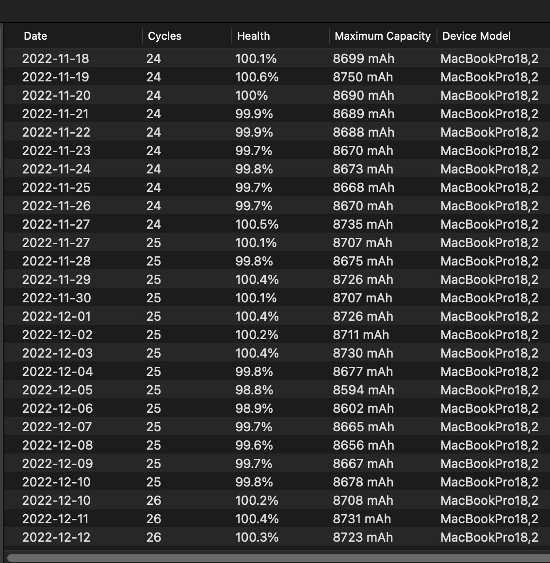

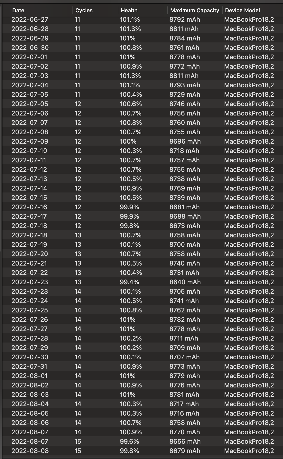

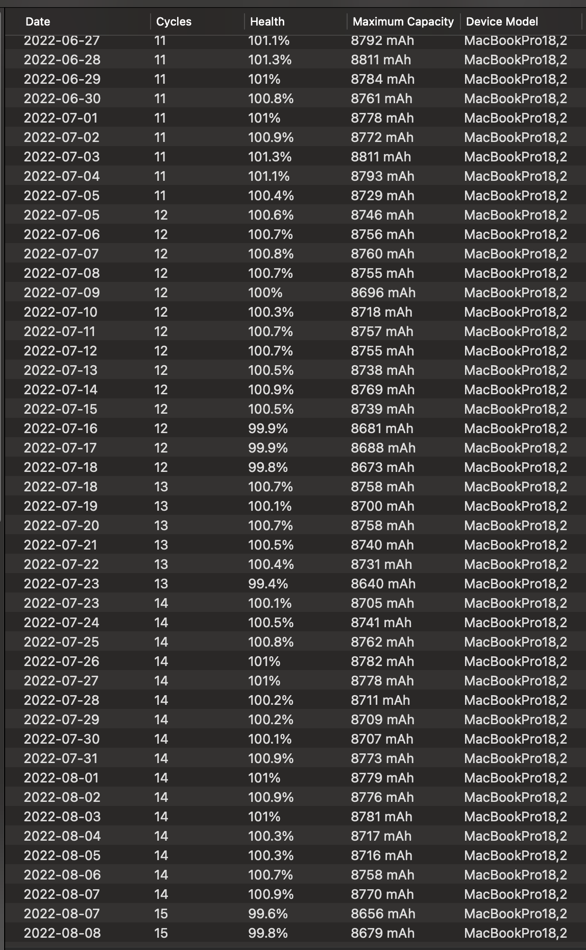

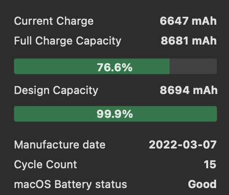

I have an M1 Max MBP and I'm an AlDente user - have been for a few years now since the days it was a GitHub package. I like it because it lets me set the % of charge that I want. My laptop spends most of its life as a desktop machine outputting to a 4k monitor. With AlDente I can vary the charge between 60%, 80%, or whatever I want.
I'm of the very strong opinion that your battery health has a lot more to do with a luck of the draw than anything... Yes, treating it right helps but getting a bad battery / good battery from the factory matters much more. And of all the Apple devices I've ever had, they've all had extremely stellar batteries.
I've had my laptop since April, got it with 3 cycles on it, and now I have 15 cycles. I have AppleCare+ so I'm not really doing much to baby this battery. It does spend most of its life on my desk tho.
That's an excellent battery health history there.
And I definitely agree that luck of the draw probably has a lot to do with it. My old 2012 is at 87% health with 1,855 cycles on the battery. I did very little to take care of that battery either (if anything, I probably did the exact opposite of what you're supposed to do. I kept it in very hot environments, did lots of 100 to 0 charges, and all sorts of other things that you're not "supposed" to do. It's still running great nearly a decade later, people often don't believe me when I tell them.)

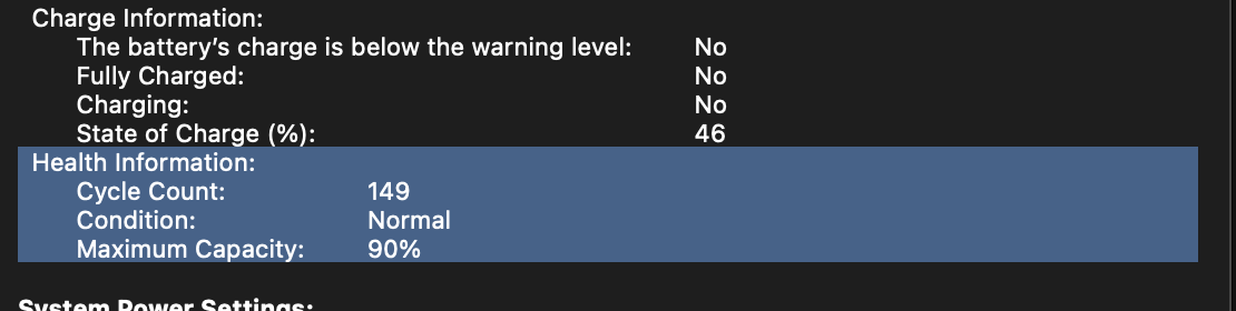

I then checked the 2020 and I've been a little less lucky, as it's currently at 149 cycles and is at 92.4%. Definitely not shabby, but these batteries are rated for 1000 cycles, so I rushed to judgment and initially assumed Apple MUST have sent me some kind of a defective battery (ah, Apple, screwing over their customers with lithium ion batteries that, you know, act like lithium ion batteries). After realizing I was complaining about a ridiculously minor problem (Seriously, who complains about a battery with 93% health), I did some research on this and discovered that this is pretty much entirely average behavior for the M1s. They tend to degrade more rapidly within the first year or so and then level off (according to the stats of Coconut Battery users at least), so it turns out my battery was fine after all.

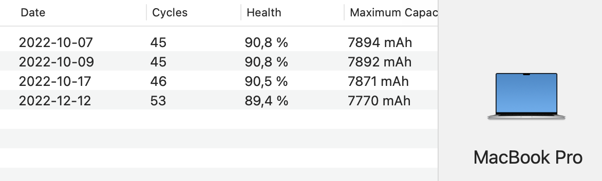

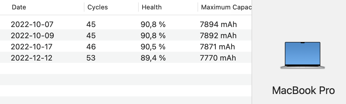

I have a different situation on my M1Pro MBP. Is it normal to have less than 90 percent with "just" 53 cycles?
skylar3
macrumors newbie
Oct 7, 2022
16
4
Here's mine.. Bought on release day and been used every day ever since for work.
Thanks for posting! It is interesting to see that you have 3x the cycles, yet your battery condition is better. I considered taking the MBP back to apple to have it checked, yet I do not believe the situation is bad enough to justify a change of battery.. probably they would tell me its "just normal".
What do you think?
What do you think?
I don't think I'd base it on that alone.
Just my opinion and thoughts -- these batteries are designed to last 1000 cycles at 80%+ capacity or something like 2-3 years.
These laptops can run entirely off of wall power if in a desktop like state - meaning that their cycles won't continue counting but they will continue to age - and if they aren't kept at a low state of charge, they will lose health significantly faster being at a high state of charge all the time. This is where AlDente comes in (allows you to run off of wall power at a low % of charge).
So User A: Uses their laptop in the field - rarely on wall power - has 300 cycles and say 98% health.
So User B: Uses their laptop like a desktop, always on wall power, has 50 cycles and say 90% health.
This seems entirely plausible to me based on how usage is. High state of charge is harmful to these batteries. Cycles aren't necessarily harmful as they used to be - the 1000 cycle limit shows this. There are some users with 2000-3000 cycles and still 80%+ health.
The OP is right. Battery health will drop fast from 100% to 90% and then taper off and drop a lot slower as time goes on - especially if at 100% charge all the time and on wall-power most of the day.
AlDente helps this health loss by allowing us to keep the % low while on wall power. I use my MBP 16 as a desktop machine 99.9% of the time and keep the state of charge around 60-80%.

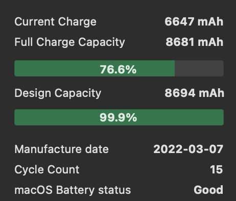

I got this laptop in April 2022 and today:

Thanks for your insights! Maybe that's the case with my MacBook, I use the it mostly plugged in, only sometimes -but not often- on battery. I trusted that the battery management from apple would protect the battery but it seems this wasn't the case.. Now I have downloaded aldente and plan to keep it at a max 80 percent, hope it protects from further fast degradation
