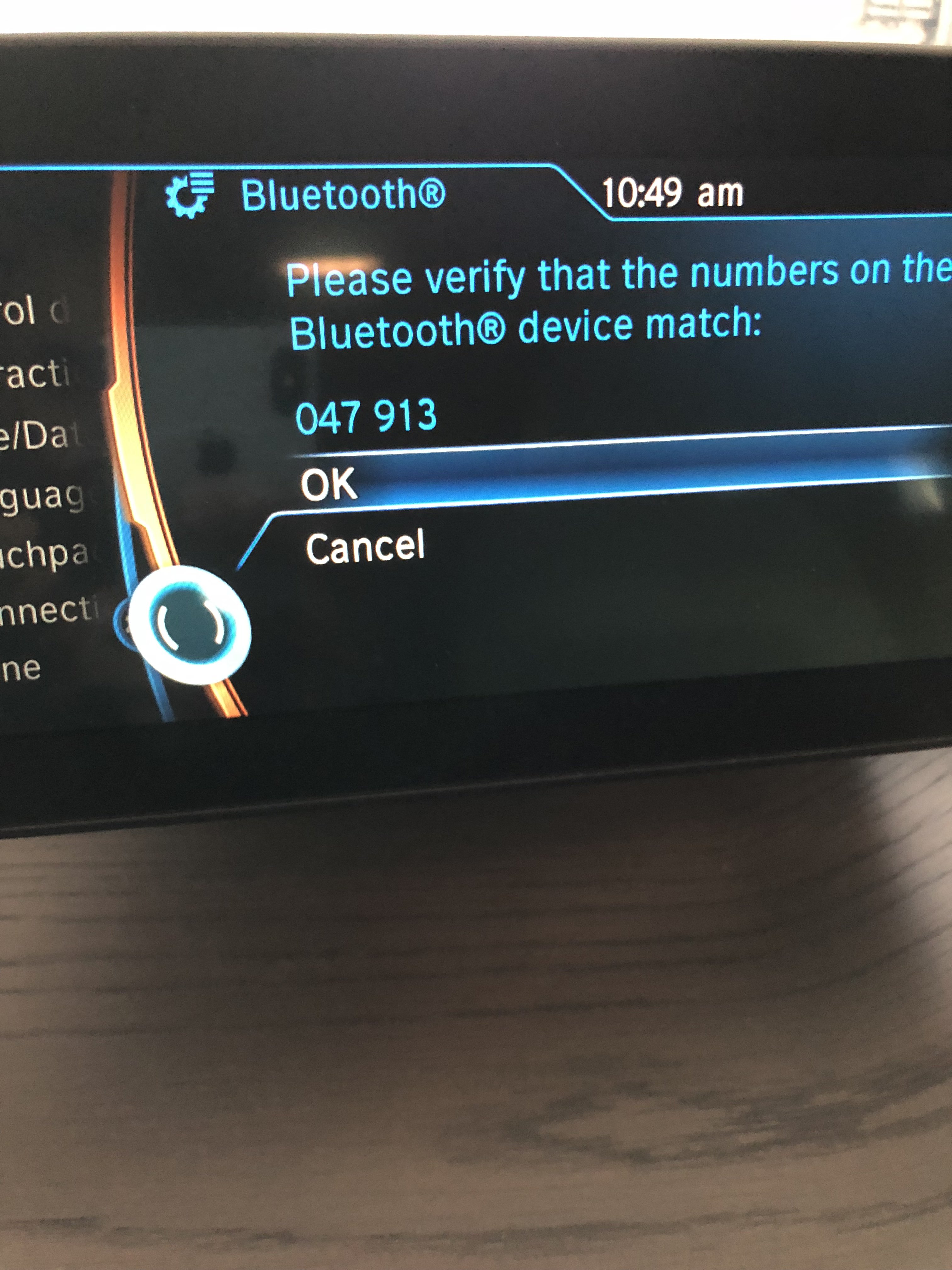

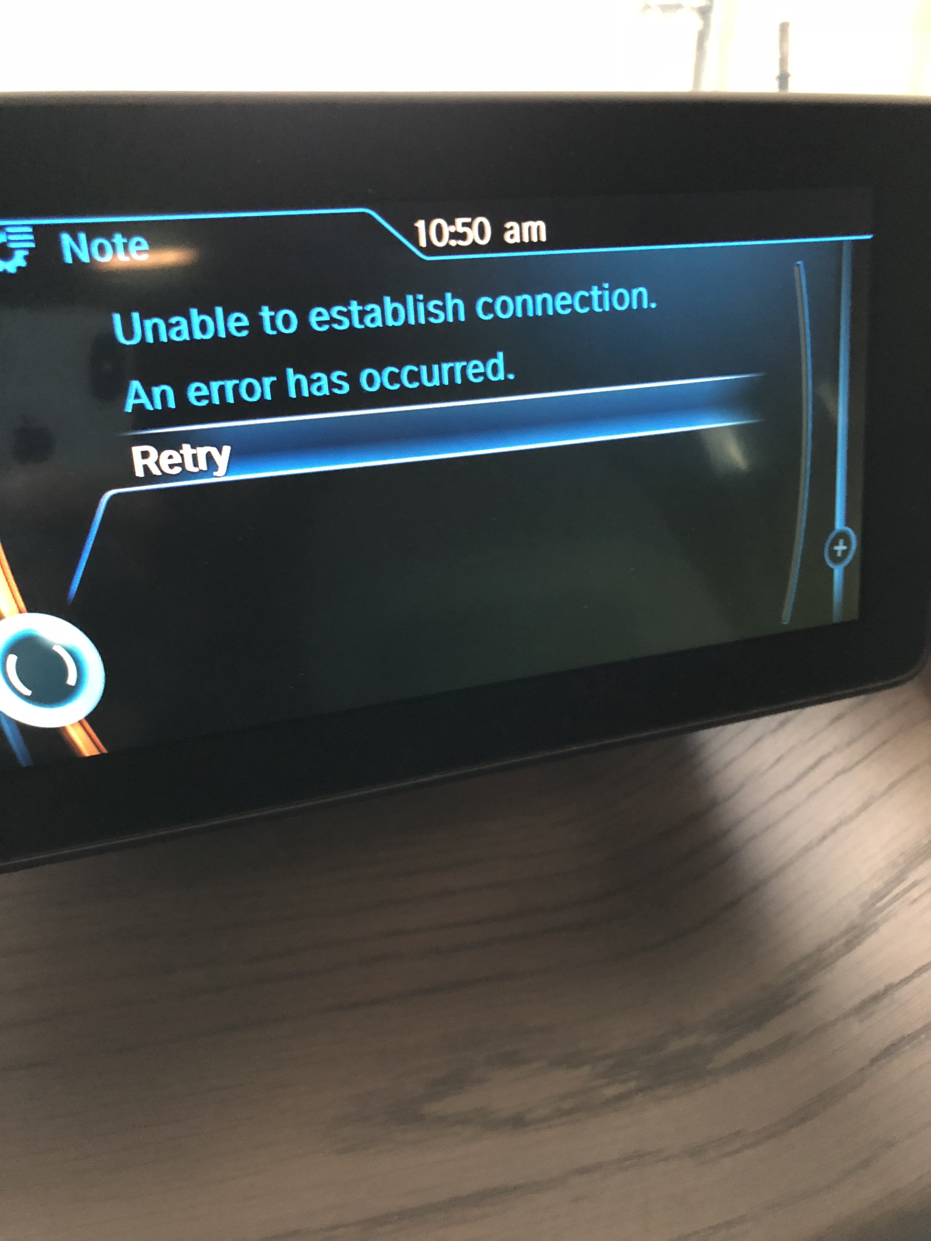

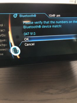

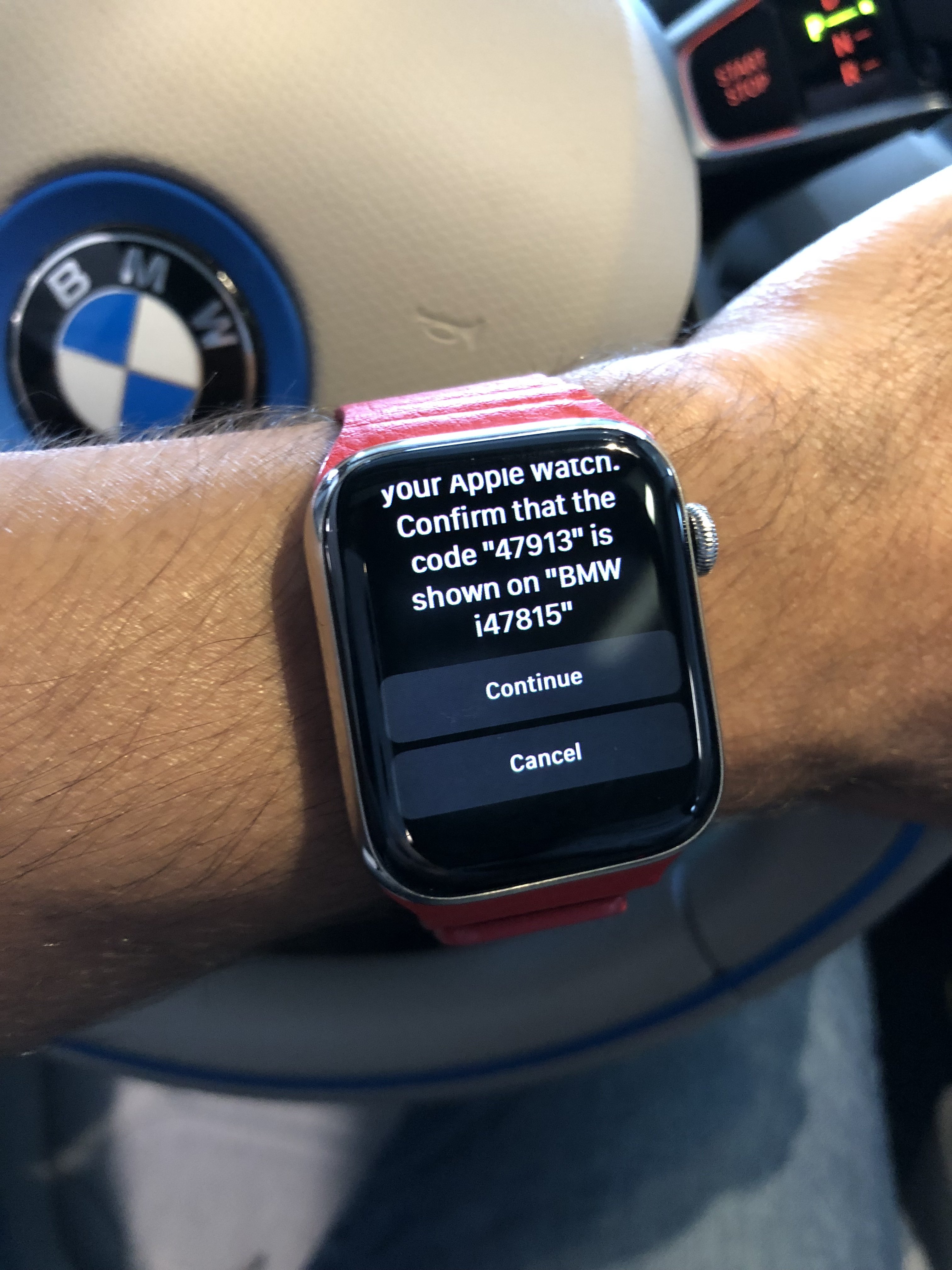

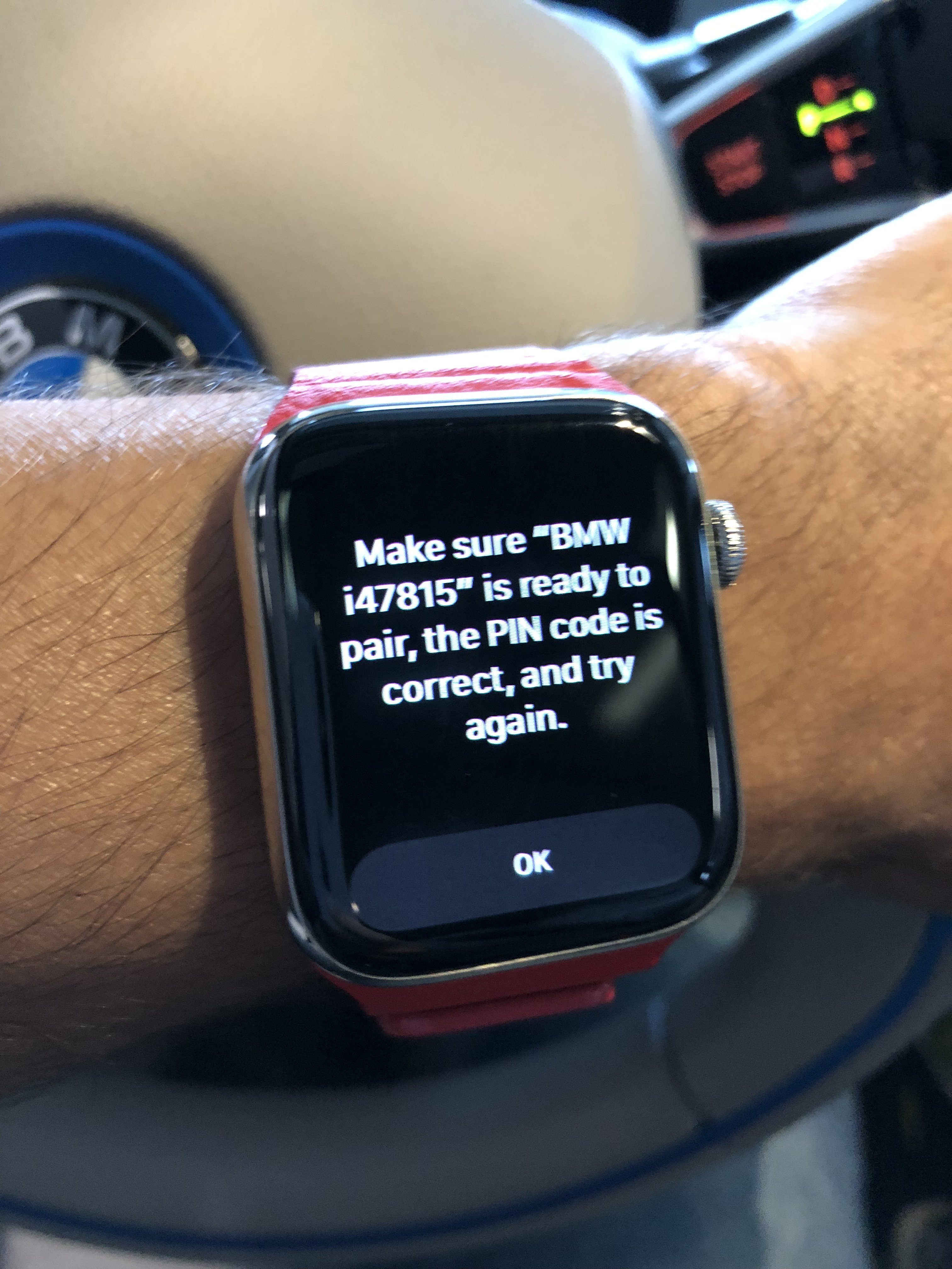

Doesn’t seem like I can adjust that type of setting. The BMW is using 6 digits, but noticed the Watch shows 5 (it cuts off the leading 0), I wonder if that’s the issue.
Some pics of the process:
25C5D299-1A52-448B-8C3E-043D8341080B.jpeg C95A0B62-8A7D-40DE-A4E2-32C482F3DAE6.jpeg
43370391-6C73-4FB8-8E23-E0CF437ADD94.jpeg 2569EF2A-A690-4BDC-B409-76B0604B5AEB.jpeg
