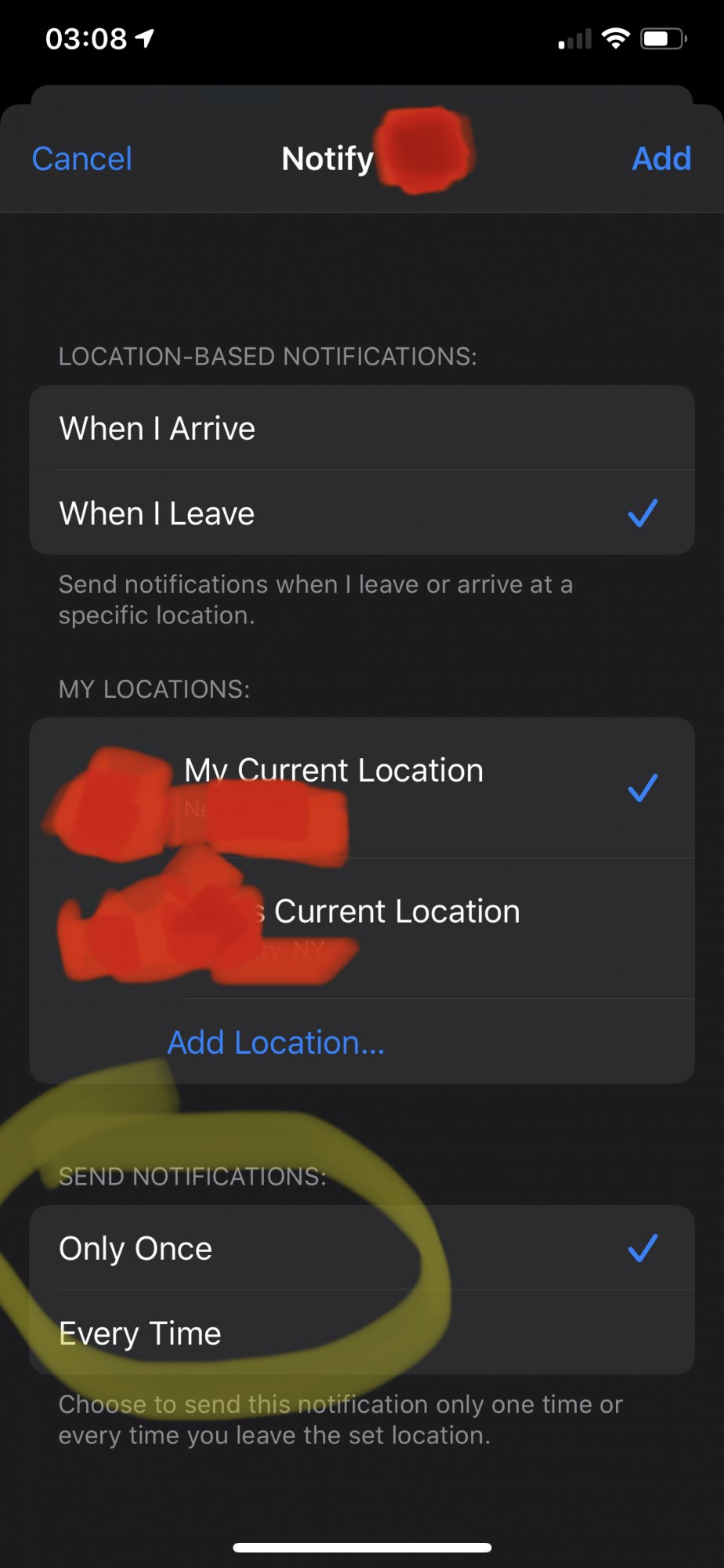

How’d you have notifications set to indefinitely? My wife and I do the same but I only see Receive Notifications Only Once.
She has to do it from her phone for you to get notifications indefinitely. If you do it from your phone, correct, you have the option to do it only once.
When you go to the notifications tab and add a notification, you have to set it to notify your wife and not yourself. From there, it will be at the bottom “only once” or “every time.” Same hold true for the other way around. I’m sure it’s a privacy thing with Apple.
Step by Step Instructions:
1. Open Find My
2. Click on your wife (either picture on map or under “people”
3. Scroll down to notifications and hit “add”
4. Should pop up an option “Notify me” or “Notify <your wife’s name>”
5. Select on “Notify <your wife’s name>”
6. At the bottom under “Send Notifications” you will see an option for “Only once” or “Every time.”
This will ensure your wife gets notifications for you every time you leave or arrive at the specified location.
If you want to receive the same for your wife, follow the above instructions but from her phone.
