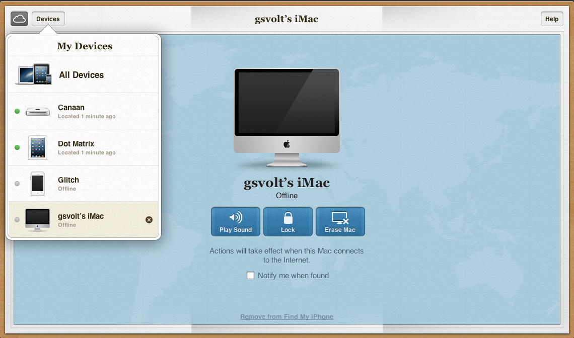

So...I don't own an iMac. How did this get in there?
Seems like someone signed into Find my iPhone with that computer. I'd suggest clicking "remove from Find my iPhone" and probably changing your password.
I would definitely contact Apple if I were you...That's a pretty big inexpiable bug (signing into Find My Devices should only show the devices that are tied to your account).
Yup, this is a good example why I don't use "Find My Mac". I don't need someone wiping my computer in the event of a bug. (I originally turned it off in the event my Apple ID is compromised.)
I called them up. As always, apple tech support is always delightful. Unfortunately, nobody there can figure out how that computer got on there, and because it is offline, they cannot access any details. They can't even figure out WHEN it was added!
This is kind of creepy. If I remove it from my list and change my icloud password, they will just be prompted for the password the next time they log in.
As tempted as I am to click "erase mac" I'm going to remove and change the passwords and see if it comes back.
Looking over everything, gsvolt's imac reappeared in my account! What the hell?
Just in case things get out of hand, I'm setting up a second time machine backup. I know know how far "erase mac" goes, but I'm not about to risk a demonstration.
It's back AGAIN! Is anybody else seeing something like this in their icloud account?
Edit: I found out who it is. He uses the same name for everything. I actually have a name and address, place of employment, photos, etc. If he's doing this on purpose, he has made no attempt to hide himself. I have to assume this is just one hell of a glitch.
