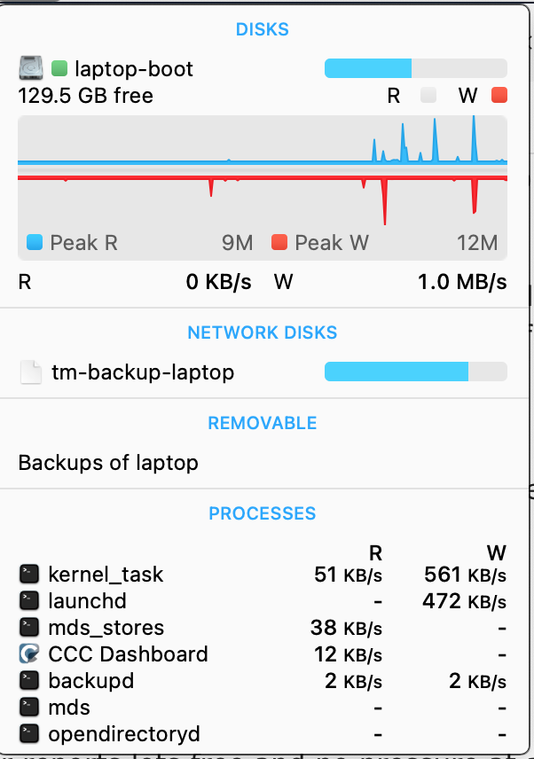

Try iStat Menus -- it will allow you to see the top few processes doing I/O. It's $12 but there may well be a free trial.
See the list of processes at the bottom of the drop-down:
Reactions: gilby101
Isn’t that the same information as in Activity Monitor?
If I remember correctly, the individual processes’ read/write numbers are not updated in real time in Activity Monitor, as the OP alluded to. In iStat Menus they are.
The problem is, none of the processes in the list show the Bytes Read increasing, so I can’t figure out what’s actually doing this
Thanks for the suggestion! There looks to be a trial, so I'm going to play around with it when I have time (and probably going to buy; it's a neat tool that I knew existed but had forgotten about).
I don't know whether, as others noted, I/O that isn't associated with a process in Activity Monitor will show up in iStat Menus, but even if it only accurately shows per-partition I/O that would still have been a big help in diagnosing this.
