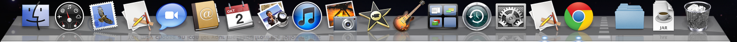

Since today, my finder is doing strange, as well as safari. Here's a screenshot of how my dock looks like, after restarting its preferences (attachment 1)
I installed an application called Docker a few days ago, and then deleted it and deleted the dock.plist, as it was doing strange. I can't open Safari, and Finder has a 'second icon'.

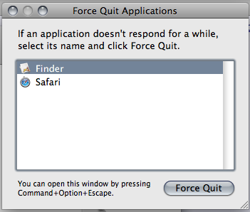

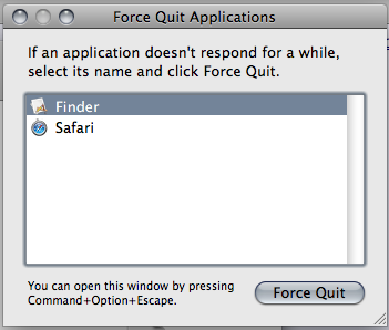

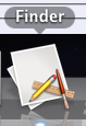

Unfortunately, it didn't work. It might be so because Finder isn't the regular app, but some strange-looking app. (See Attached Images) Also, when in the Force Quit window, Finder can't Relaunch, but instead is just Force Quit, just like any other application (See Attached Thumbnails).

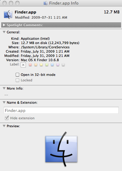

The 'Finder' is in: HD/System/Library/CoreServices/Finder.app.
Check if it has the proper Icon like this:
If the Icon is as you showed, that's a 'generic' icon & the Finder has to be fixed.
You'll have to re-install it.

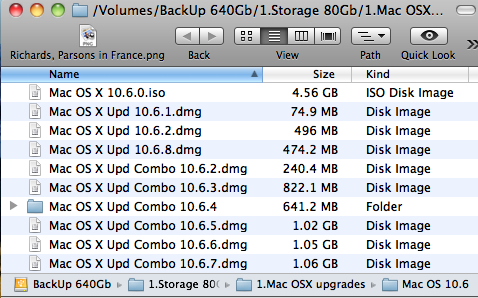

Unfortunately the 'Finder' can't be extracted from 10.5 or 10.6 DVD with 'Pacifist' (at least not with v2.6), you'll have to re-install the OS. (I just tried to do that with both DVDs).
If you have the 'Install DVD' then you can reinstall the 'Mac OS' only (installer will not change anything else).
If you're still on SL then you should download (& keep) all the updates, like this:
If you have any of the updates then it'll fix the Finder.
