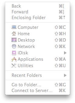

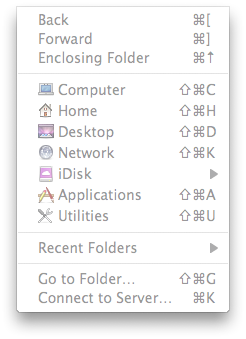

Hey all,
When I boot fresh into Mac OSX, the pull down menus for View, Go, etc. are all grayed out (refer to pic). Also, I have to manually connect to the Wireless here at work (use to come up like a charm).
Now, if I click Finder in the dock, or any app for that matter, the menus are back to normal, but still have to connect to wi-fi manually.

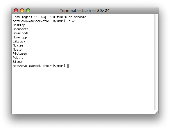

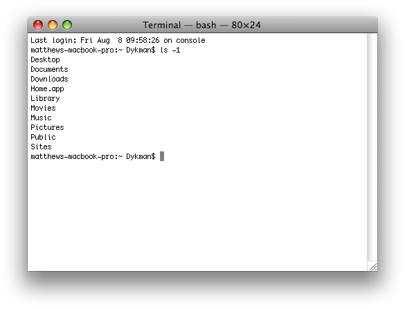

Hmmm....
Not sure why I got this, it looks rather different.
There we go. My bad.
Not sure where the "staff" comes from.
