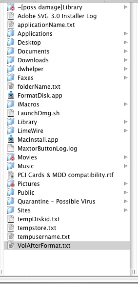

So here's what I did.
1. Renamed the baduser/prefs folder - restarted, prefs folder rebuilt itself result. result- No meaningful change. 'Finder cycling' stopped but finder quits at any instance of clicking a sidebar item, or attempt to open Documents folder.
2. I Left the 'new' rebuilt prefs in place & Renamed baduser/Library Folder, restarted & let that Library folder rebuild. Result- finder wasn't 'cycling' but quit at any instance of clicking on the sidebar.
3. I used Grab to take a pic of the Folder... Users/baduser in column view, showing all the remaining folders in the user account. I'm amazed that's apparently not either the prefs or the Library folder.
BUT!
If I Log out of baduser, login to testuser, there are no finder quits at all. Finder Operates normally. huh?
So it must be something else in the baduser Home Folder that's at least contributing to this.
Possibly...
I'm at a loss, probably missing something obvious.
Attached is the window grab from baduser/, as viewed from 'testuser'. The Library Folder seen in the grab is the 'new rebuilt' folder.
(for some reason, you'll have to click on the small pic below to view it in a reasonable size)
T
  • baduser:folder contents.jpg

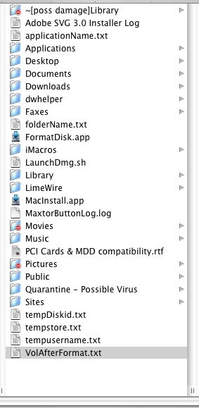

BUT!
Possibly...
T
So, still not solved, this is a hard one, I never came upon a conflict like this which wasn't solved by removing/renaming Preference/Library Folder.
