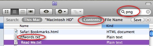

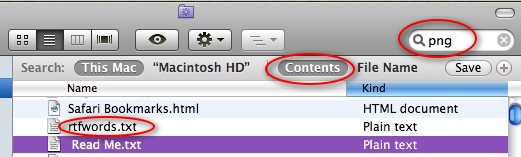

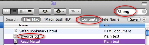

Whenever you search with Finder, just click the option to search Contents instead of File Name to search the contents of files:
As you can see from this search, the highlighted file doesn't have png in the name, but it does in the contents.
