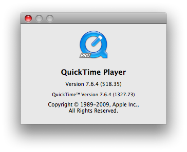

I believe this is the latest version.
QuickTime Pro
v7.6.4 (518.35)
