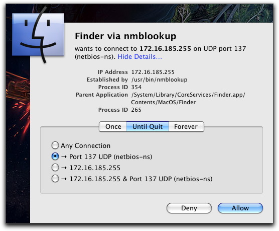

Restarted my mac from running bootcamp and the attached image popped up. This is the Little Snitch UIAgent catching something. WTH is this tho?
In plain simple english please! Just telling me that the nmblookup program resolves NetBIOS names into IP addresses is the obvious bit. What is it doing and why?
If I who-is the IP I get this:
http://who.is/whois-ip/ip-address/172.16.186.255/
And I'm just ignorant enough to not be enlightened AT ALL by any of the information there.
Any ideas?

Upon further investigation I found out that according to RFC 1918 the address in question is local kinda thing:

nmblookup is related to Samba and Windows File sharing on your local network. 172.16.186.x is probably bound either to your local network or Parallels/VMware virtual network adapters used for NAT. In terminal run ifconfig and check what adapters you have.
It's sending to 172.16.186.255 which is the broadcast address.
This is nothing to worry about. As you found out, 172.16.x.x/255.240.0.0 are reserved addresses and won't go out to the Internet.

It's finder looking for neighboring machines on your local network, trying to populate the "SHARED" section of the finder sidebar. Totally innocuous.

Hmmm, yeah, I get this:
vmnet8: flags=8863<UP,BROADCAST,SMART,RUNNING,SIMPLEX,MULTICAST> mtu 1500
inet 172.16.79.1 netmask 0xffffff00 broadcast 172.16.79.255
ether 00:50:56:c0:00:08​
vmnet1: flags=8863<UP,BROADCAST,SMART,RUNNING,SIMPLEX,MULTICAST> mtu 1500
inet 172.16.185.1 netmask 0xffffff00 broadcast 172.16.185.255
ether 00:50:56:c0:00:01​
So I still don't understand though. Parallels is establishing those IP addresses for what? And what has Finder got to do with it? Why would Finder want to send anything to those addresses?

nmdlookup is attempting to find a master browser, and it does this by sending a broadcast to the locally attached networks.
vmnet adapters are virtual adapters used to either NAT your VM's to your local network or give your VM's host-only access. In VMware vmnet8 is the NAT adapter, vmnet1 is the host-only network adapter.
If I were you, I would go into little snitch and add these as local networks so little snitch doesn't alert you to anything their doing. Little Snitch is really only most effective to report traffic destine for somewhere not-local, such as on the internets somewhere.
But it never did this before. And I haven't updated Parallels or anything. What? It just now started working? Sounds odd.
What is a "master browser" and what is it's purpose?
OK, so that explains what is at those addresses. Why would finder send something or poll them? Just to populate the "SHARED" section like Nugget is saying? And why didn't it ever do this before? Nothing's changed. <shrug>
