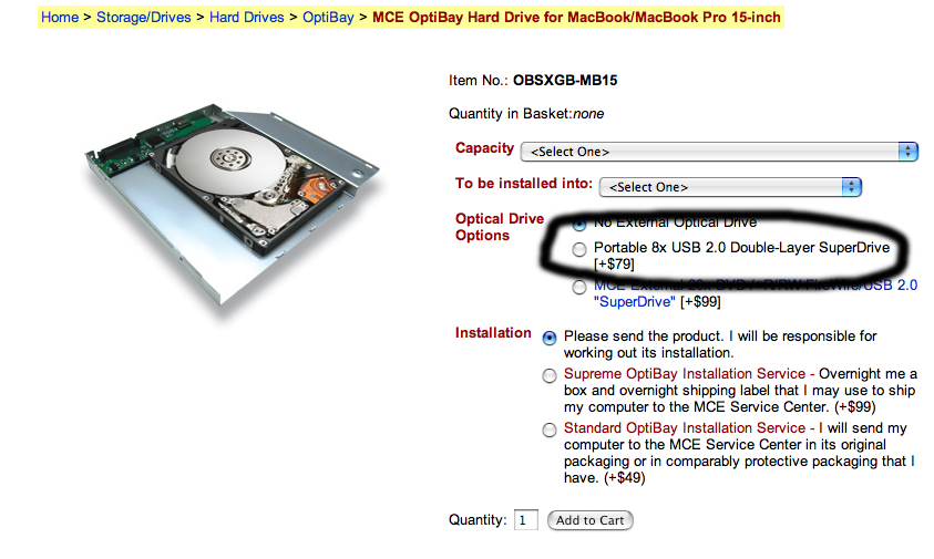

I found an enclosure at mce, but I think you have to purchase their optibay caddy to add that to the order.

MCE OptiBay Hard Drive enclosure
Here: http://store.mcetech.com/Merchant2/...7&Category_Code=STORHDOPTIBAY&Product_Count=1
They have one for $49 that lets you use your removed SuperDrive externally via usb.

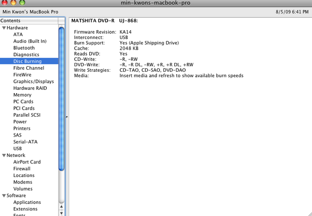

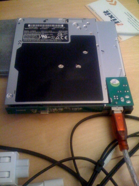

I received the enclosure today. Simple plug and play. It uses the same exact controller as linked above. So if you want to save a few bucks, you can just get the controller for $9 here
I'll add some pictures later.

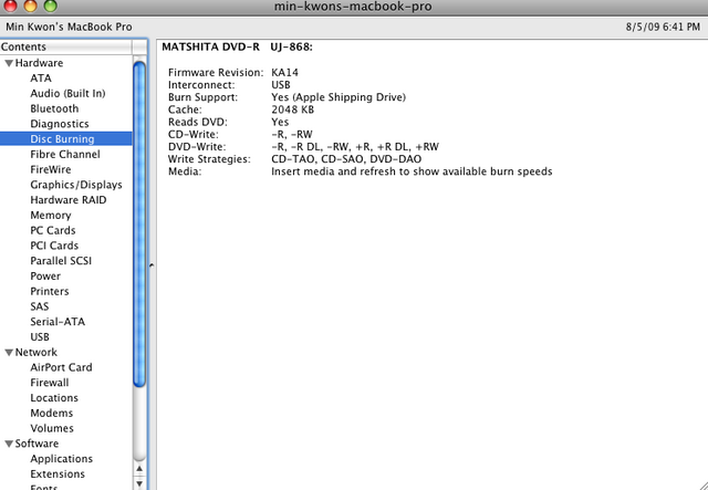

Got the adapter today. It works perfectly.

I bought on of these enclosures for this EXACT reason a few weeks ago. Problem is I can't get the disk drive to work. (It works in windows with the driver)
It Registers the USB to IDE device in the system profiler, but no DVD drive.
Anyone have any ideas? (By plug and play you mean no drivers what soever right?)

best to buy a macbook air superdrive and crack it for $ 9.00 ..
i have done it, works 100% and is done in 1/2 hour.
p.s. works as expected with only the usb-connection (1) ...
