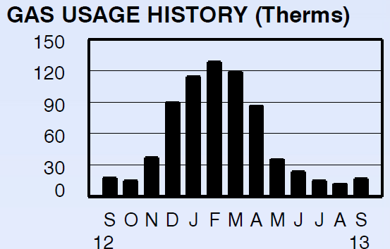

I've got about 2200 square feet. Right now my mother in law is staying with me. so 3 adults and 2 children. We take showers every day, use the stove and/or oven every day and use the dishwasher almost every day.
Just got my most recent bill and we used 16 therms last month. Last year it was the same amount.
Over the past 12 months. November to May are the only times I go over 25 therms.
I am in NY, and last year we had a really cold winter (forced hot air furnace).
I think something is wrong with your meter or another apartment may be connected to yours.
I also have my water heater about 75% of the way to the max setting because the dishwasher works better with really hot water.
