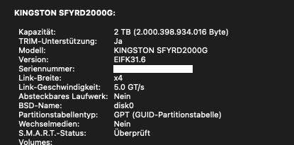

I chose the Kingston Fury Renegade 2TB
Hardware

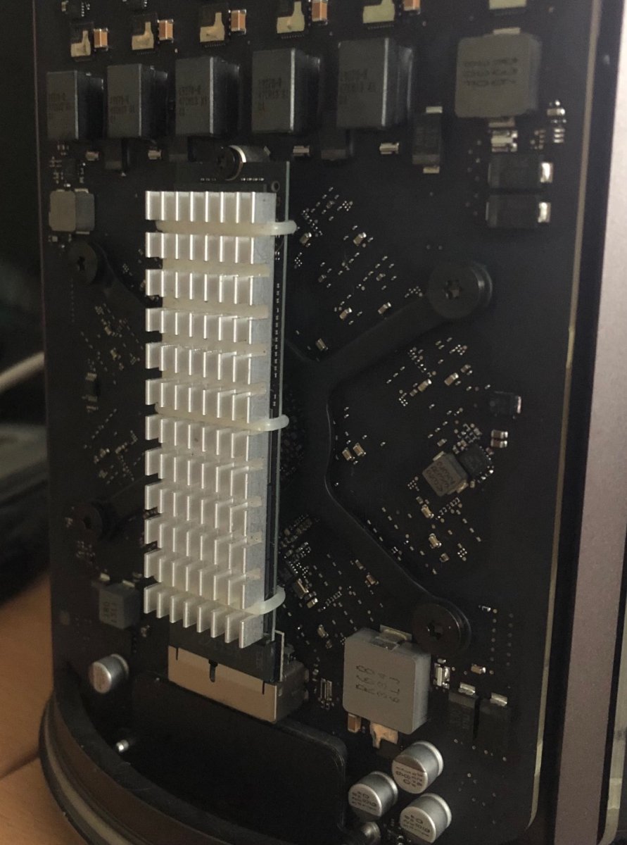

Adapter is the small Sintech

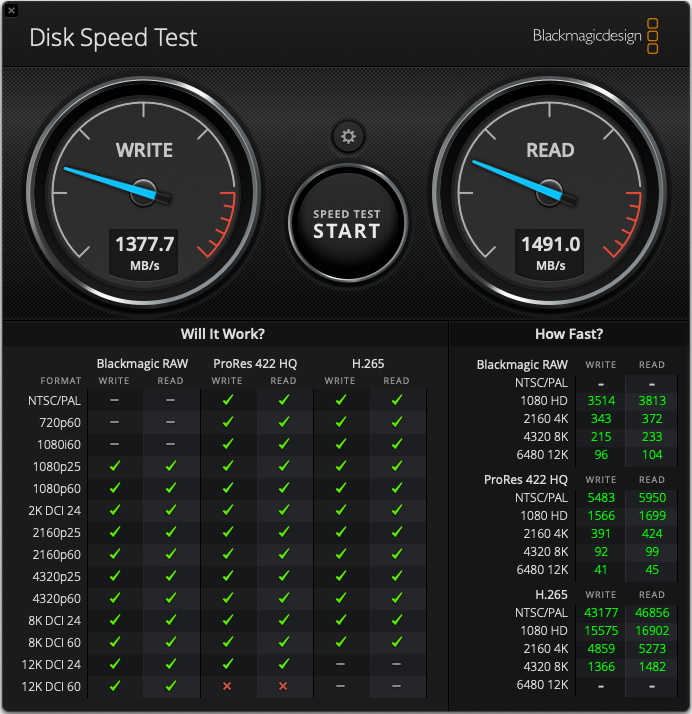

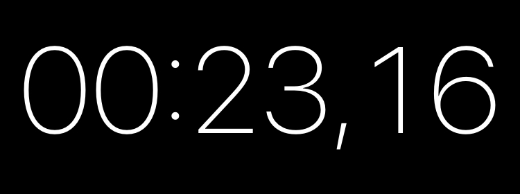

Benchtest

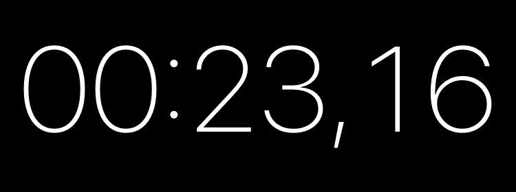

Boottime from pressing the button to login screen

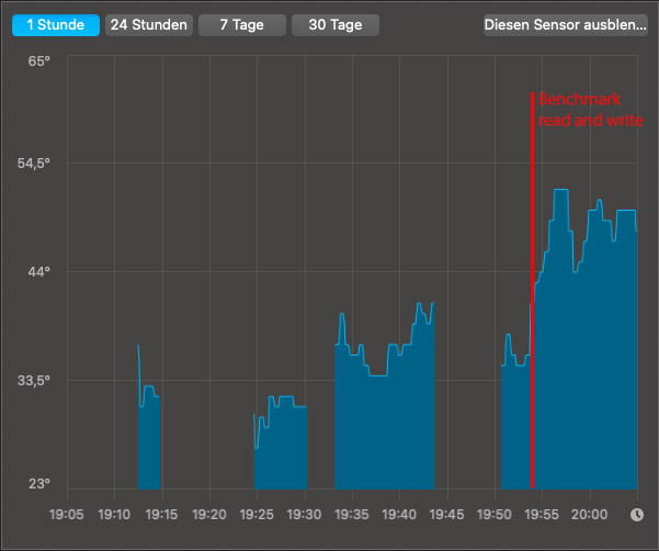

Temperature

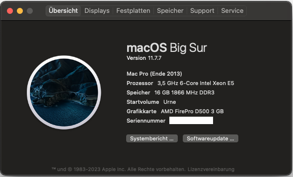

Big Sur and Window 10 is running on the 6,1. Until now I haven't found any problems. No beachball, no Lags, no waiting after pressing the button. Windows also running well.
I have a 2TB 970 EVO Plus for more than six months. with my late-2013, no issues. You gonna need a heatsink for sure if you buy one 970 EVO Plus.
Several people on MacRumors prefer Toshiba/Kioxia XG6 and XG6-P blades, TRIM works fast and the blades are not so hot like the 970 EVO Plus, but it's unobtainable locally to me.
If where you live do not have scorching summer days, maybe you can avoid installing a heatsink, but probably everyone not near the Arctic will need one, even with somewhat cool blades like XG6. Clean installs and the indexing that happens right after can get a non-heatsinked blade to more than 70ºC in mere minutes.
