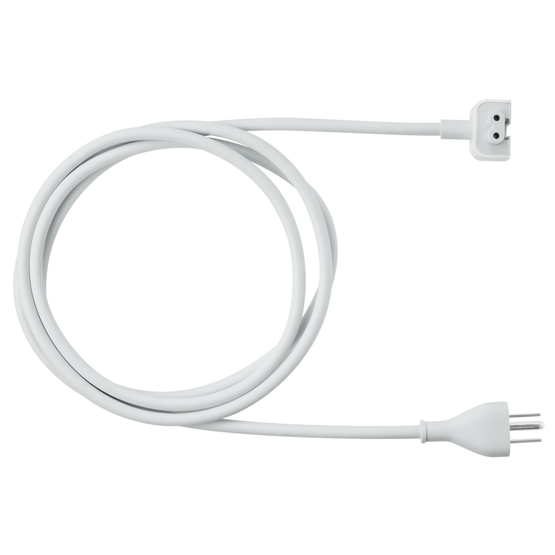

Are you using the original power adapter with the properly grounded three prong cable?

Or possibly your building grounding is faulty. Again, try it in a different building. Otherwise, if you replace it, you may find you have the exact same problem with its replacement.

Apple chargers don´t have ground prong or pin or whatever it’s called. I’d contact Apple. It’s NOT a normal behaviour
Apple chragers don´t have ground prong or pin or whatever it’s called. I’d contact Apple. It’s NOT a normal behaviour
They actually do. The metal stub that the connector is sliding on is an earth stub and on some cables the connector on the stub does have an earth pin connected to this stub.

I have exactly the same 'intermittent' fault. Never clicked it only happened when my M2 Air was on charge - spent ages on the phone to apple, did multiple restores (as requested), created multiple admin accounts (again, as requested) and ran multiple diagnostics all to no avail.
Apple refused to accept a swap within the 14 days, then someone on here mentioned the charger not being grounded.

Why can you not accept the charger diagnosis? It's highly likely the reason.
Use the provided one, or buy a higher quality USB-C charger.
