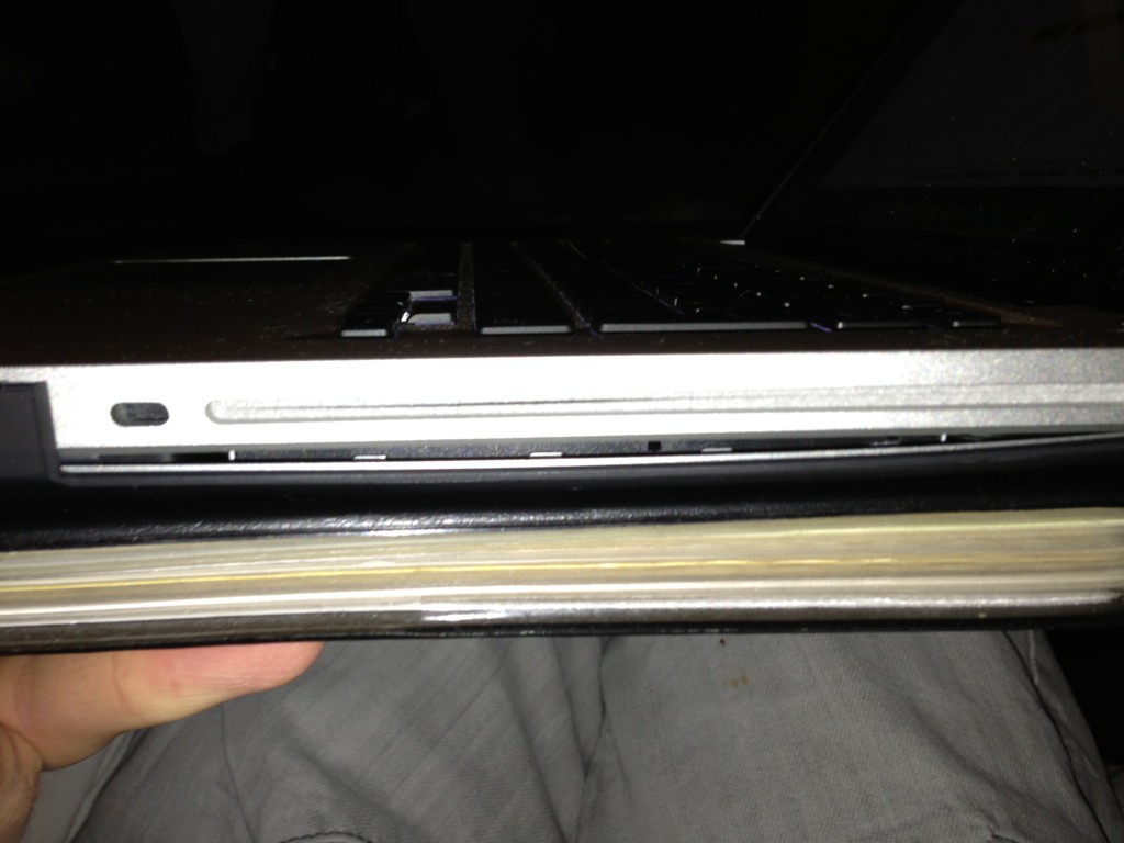

The back of the Macbook Pro, its lid, is not flush. The HDD was thicker then the superdrive and so the right side of the lid does not sit all the way down. I am not sure to leave it or just put the SD back in?
What would you do guys? The good news is it all works, but just don't think I like the lid not sitting down all the way.

Sounds like the OP's caddy is bigger (deeper) than the optical drive and the HDD is sitting proud.
Exactly it, see picture above. I will be taking it out tomorrow and just keeping the SSD in.
I think you just got the wrong caddy. I know lots of people that have done this without having the problem you are. Where did you get the caddy?
Are you absolutely positive you installed it right? Do you have a 'normal sized' SSD? (Some of the larger capacity SSD's are extra thick).

I used the OptiBay from OWC, and it seems to me like it could have been installed upside down and produce the same results you got (though I don't think the screws would work in that case)

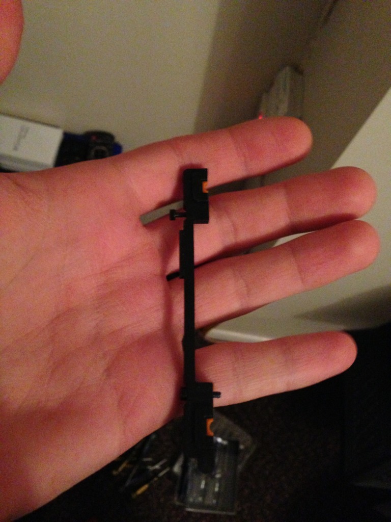

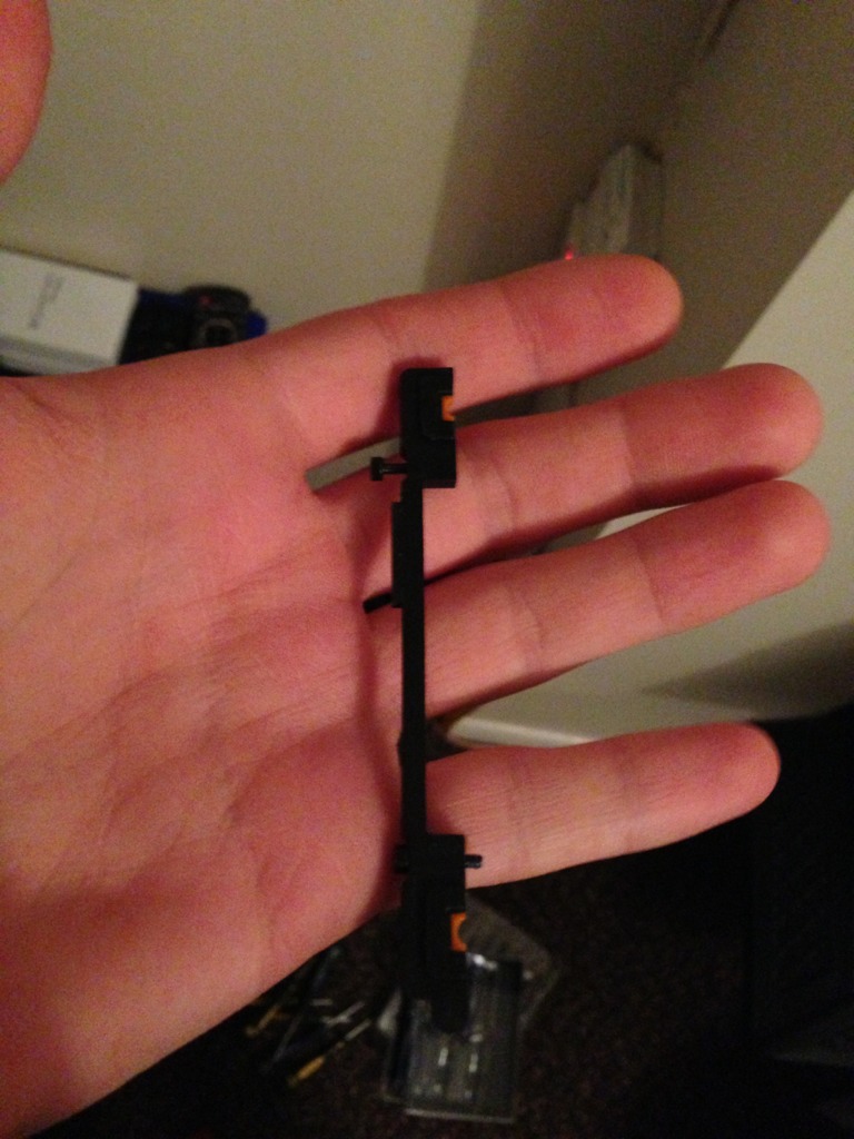

You need to remove the black plastic part at the back of the caddy. Undo all the screws on the caddy, and remove the black plastic part. It should now sit flush.
This had me all confused at first too, but it almost seems like the optibay was built for another computer...but once you remove that black plastic tab bar thingy, it's all good.
I think you had the same problem as me.
Is this the black plastic tab your referring to? If so it's already out.ImageUploadedByTapatalk1356205115.547608.jpg
