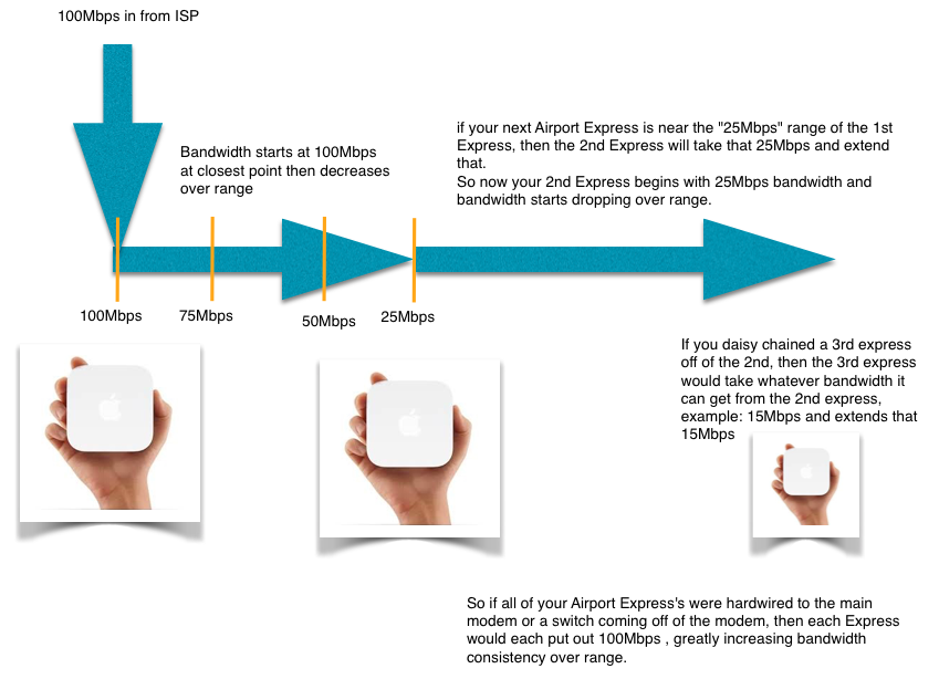

I'm posting a fairly basic diagram to hopefully be able to help explain.
It sometimes gets confusing because you could be at your 3rd Airport Express and your laptop may be connecting to that 3rd Airport Express at 100Mbps but that is the WiFi network directly beside the 3rd Express but that doesn't mean you are getting 100Mbps of internet related bandwidth.
I had an instructor that put it into this example.
You start with a 8 lane highway and it is carrying 100 cars on it, well the lanes get less and less over range so near the end of that highway you are down to carrying 25 cars. Now you come to another 8 lane highway but you still only have the same 25 cars and after a while those cars drop off the road and you hit another 8 lane highway and now you have 5 cars on it.
The highways represent the connection to your WiFi access point and the cars being your internet bandwidth.
You can always increase the lanes for traffic (by adding extenders) but you don't always get more cars on the road(internet bandwidth). The only way to better keep high bandwidth would be to hardwire all the Express's. Thus for sake of the example, create a super highway loop where the lanes didn't decrease, at least not within your area of use.
I probably thoroughly confused anyone reading this but somehow it helped me grasp it better.
