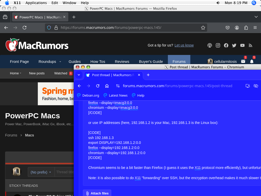

This screenshot is actually a bit of a lie: when I tried to attach a file in Chromium, it locked up, and I had to make the post using Firefox instead.
It does show the strange blue issue with Chromium though.
