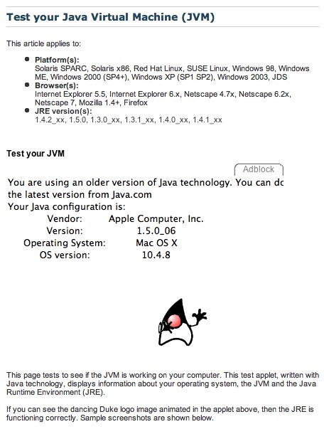

If I go to http://www.java.com/en/download/help/testvm.xml
Ok, Thanks for the responses thus far, to update all, I have done more than the suggestions given. I investigated further and found that Safari, had the same problem. I went to the "Mac Genius Bar" and checked out a vanilla install of OS X 10.4.8. Theirs worked.

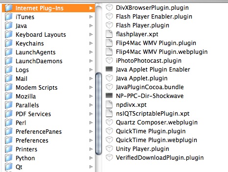

By this point I had:
Disabled all plugins that I added
Removed Firefox
Re-added Firefox
Reinstalled Safari
- Tried this by removing Receipts (didn't work)
- Then just mounted the CD cd'ed to the Volume and pulled the safari.pkg out and installed it individual package
Then I backed everything up to an external drive and reinstalled OS X 10.4, patched, restored my home dir and settings (minus plugins)
and.....
Voila, Java was seen by both Safari and Firefox
Removed Firefox
Re-added Firefox
Reinstalled Safari
and.....
