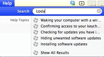

OK, I thought that post was meant for me. I'll try what you said. Absolutely ridiculous question here. Where is the check for update button in FF? I can't find it in the menubar or preferences. I know it's at the end of my nose. All I've found is the checkbox to "automatically check for updates".
OT: this forum is getting slow again....

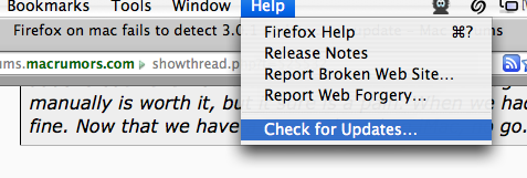

here is the place you can find "check for update"

Dang it. I knew it would be somewhere like that. Thanks. I guess the help menu in Leopard searches only the menus other than itself.
