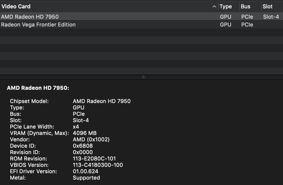

I've gotten my hands on a W7000 and I'll play around with flashing it. If anyone has any advice let me know.
I flashed the W7000 with the ./makerom.sh but I think I've ran into issues with the frame buffer as I don't have output on any of the ports.
I did get updated information in the System Profiler though.
Attached is a zip with both the original rom and my flashed rom. Hopefully I can learn how to fix it.
AFAIK, you can NOT change the Framebuffer. The only way to fix the card (not fix the EFI ROM) is just flash the original firmware back in. It seems you can boot with the Vega FE co-installed and flash the W7000 again.
