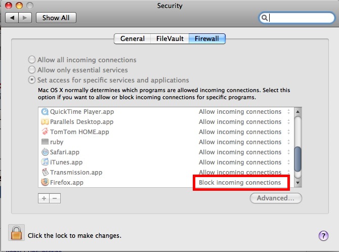

I just had a look at my firewall settings, all the programs I would expect have "allow" set for incoming connections..
Except Firefox. it's blocked. Except that it's my main browser at the moment, I'm using it to post this!
I've heard reports of leopard's firewall being next to useless, but if something is set to block, and it allows connections, it's not only useless, that's boldly marching into the dangerous territory.
Am I misunderstanding this, or is this just broken.

It means that it has blocked any incoming connections, but it doesn't mean incoming data. When you browse the internet, your computer makes a connection to the web server, and then data is transferred back and forth along that connection. It's like you ringing a friend, and then the two of you talking back and forth during the phone call.
When the Firewall says that incoming connections to Firefox are blocked, it means that Firefox can't accept any incoming connection requests from the outside, which hopefully stops malware trying to pry its way onto your machine.
Everything is working perfectly well, it's just the way Arnel explained it. Since a connection has a well established meaning in the networking world, I doubt this thing is badly mislabeled.
Arnel is exactly right, but since you aren't running a web server you don't have to block it in your firewall. There is nothing to block.

It refers to IP connections (TCP, UDP for example). Connection has a very specific definition. Going back to a previous post, I will repeat: Firefox opens a connection to macrumors, not the other way around. Data will flow both directions on the connection, but the firewall in this case is only set up to block INCOMING connections, and in the case of Firefox, there is no incoming connection under normal use.
Let's assume for a minute that someone gave you a bogus trojan Firefox. You could be using it, and the bad guy could try and open a connection inbound to your faux-Fox. That would be blocked by the firewall.
Yeah, it makes sense now, but it's not realy a typical apple user friendly way of putting it.
