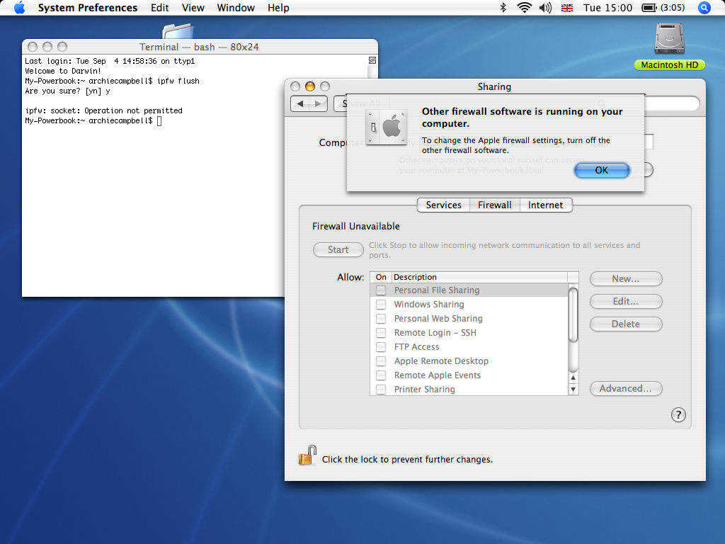

Damn, It seemed as though it was going to work! Then this happened!
Dont know what the solution will be!
EDIT: sorry dont know if it makes any difference but sytem preferences was not open when I tried the command!
Looked great! I got this lovely screen
But to no avail! I still get this irritating screen!
I reckon I/we are getting closer to the solution though!
Thanks

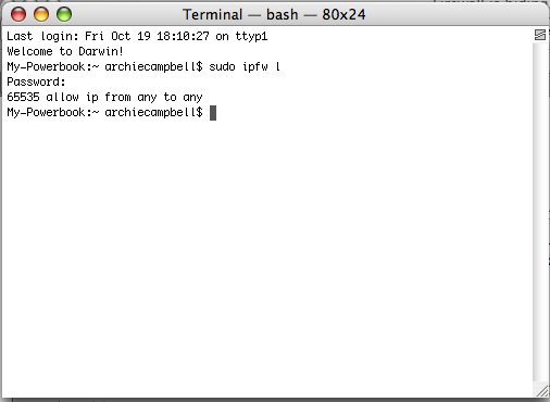

Code:
sudo ipfw l
(that's a lowercase L)
This will list if ipfw2 is actually doing any port blocking. Default is:
Code:
65535 allow ip from any to any
If that is what you see, then it's something else.
Ok i did that but I got what you had quoted?
(see picture)
But im confused, what does OSX think is acting as a firewall if all the ports are open?
Anyone shed any light on this?
And thank you to Yellow for getting me one step closer to the end of this conundrum!

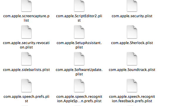

ipfw is ALWAYS running. The default is what you see above, all ports open.
My guess is that the GUIfied control for ipfw is either out to lunch, or it thinks another firewall is running.
You can try to nuke:
/Library/Preferences/com.apple.sharing.firewall.plist
Restart
And check again if you can start the firewall up. If not..
Restart
....and if its still a problem, bootup with no extensions running (hold shift during startup sequence). If you can then access firewall settings via Sys. Prefs, you might find a leftover in /System/Library/Extensions or in your Startup that is setting up a rule that is starting under normal boot.

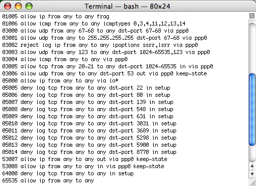

nah, Little Snitch wouldn't do it.
So.. restart. Then when you login, give us the results of:
sudo ipfw list
sudo ipfw list
OK will do, currently caught me burning a DVD so it will be a bit but after that I will post straight away!
OK so i did that and got some rather odd results (see picture) I dont know if any of these are personal to me (as in I should blur them) so I have posted it completely uncensored, also I then successfully "sudo ipfw fulsh"-ed and now the sharing iTunes is working again!
Thanks again!

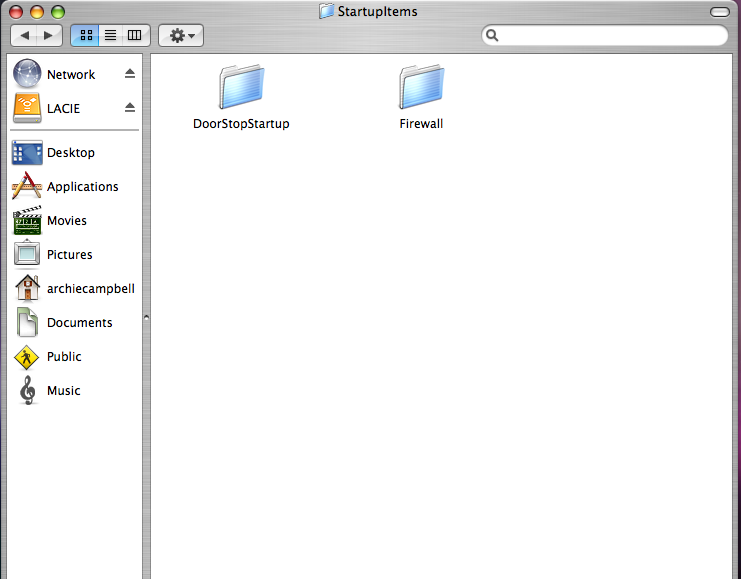

Yeah, since you got that at startup.. something else is controlling ipfw.
You'll have to empower yourself to find out what it is.. perhaps something in /Library/StartupItems/ will lead you to the cause.
:-O
Okay couldnt have spelt it out more simply!!!
Do you think getting rid of this will solve this long running problem?
