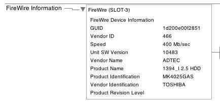

also, my disk is made by Adtec, a japanese company. i bought this disk in japan. it's not very clear what version of firmware this one is running. the closest i see in the apple system profiler is "Unit SW Version: 10483." (See image on next post.)
could someone else check their FW400 HDs to see what kind of information they see on the system profiler? thanks.

Just to clarify, the firmware revs being discussed are for the Oxford 911 and 922 ide/fw/usb2 bridge chips, not the actual hard drive (ide/ata).
yeah, sorry, it was the bridge chip inside the enclosure that was labeled as Oxford 911... not the 2.5" HD itself.
