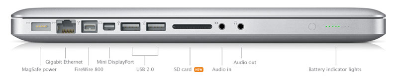

Your MBP has a Firewire (FW) 800 port with 9 pins.
Your camera has a so-called FW 4-pin port.
_original
You need a 4-pin to 9-pin FW cable.
