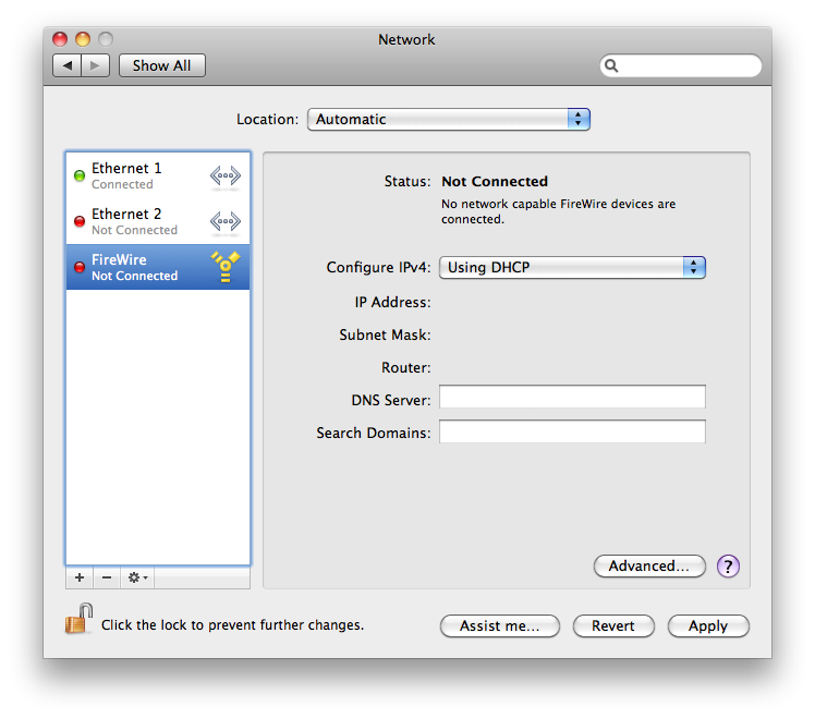

Not sure if this affects FW or not but have you checked that the firewire settings haven't changed in NETWORK.
(system Prefs- NETWORK)
