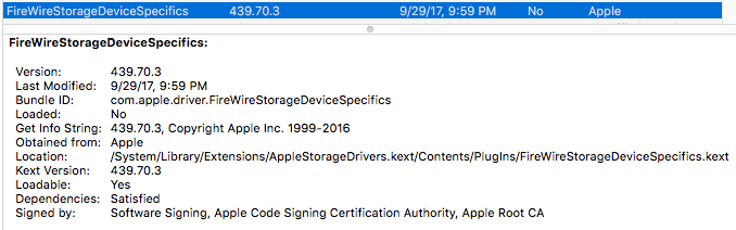

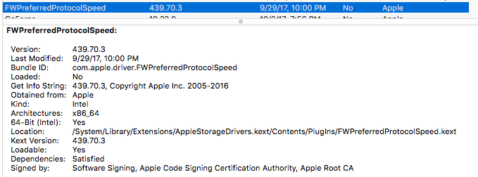

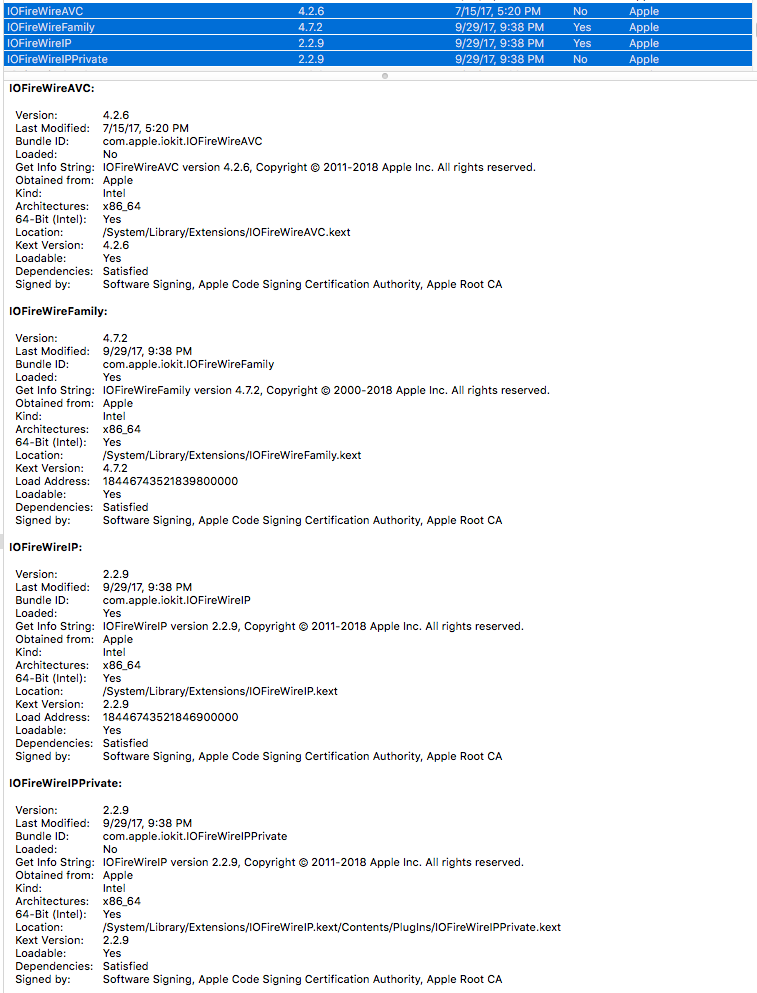

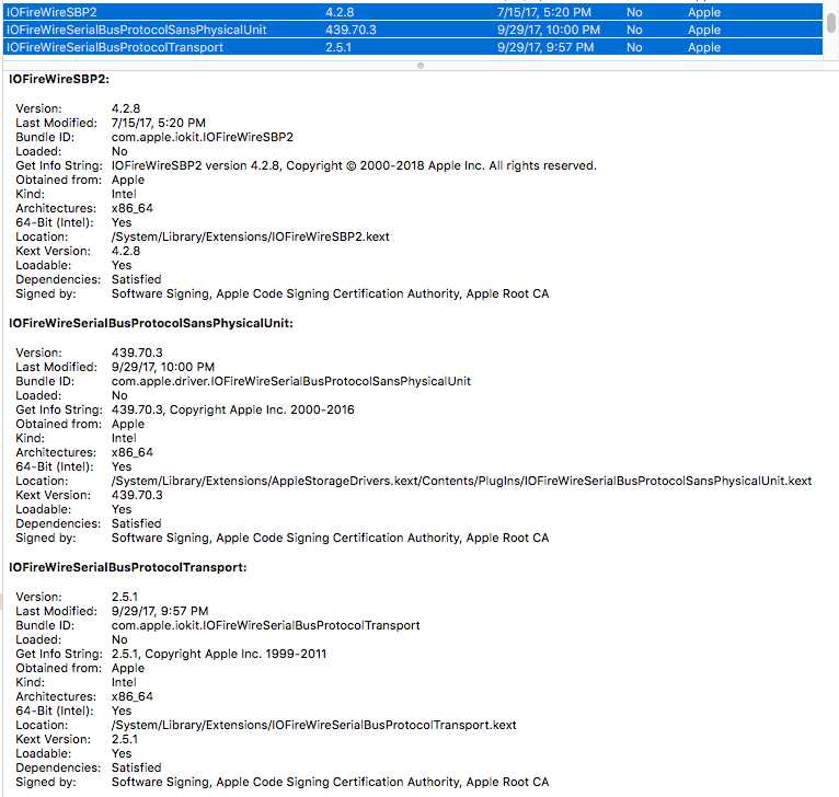

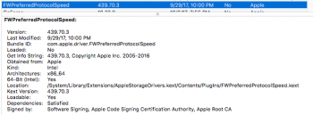

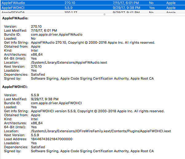

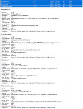

Look at the .kexts between your clean install of Sierra and non-clean install. Here's the FW relevant ones. Not all of these are required for functionality. Worth a check if you're looking to troubleshoot. Think a point update messed with FW.
