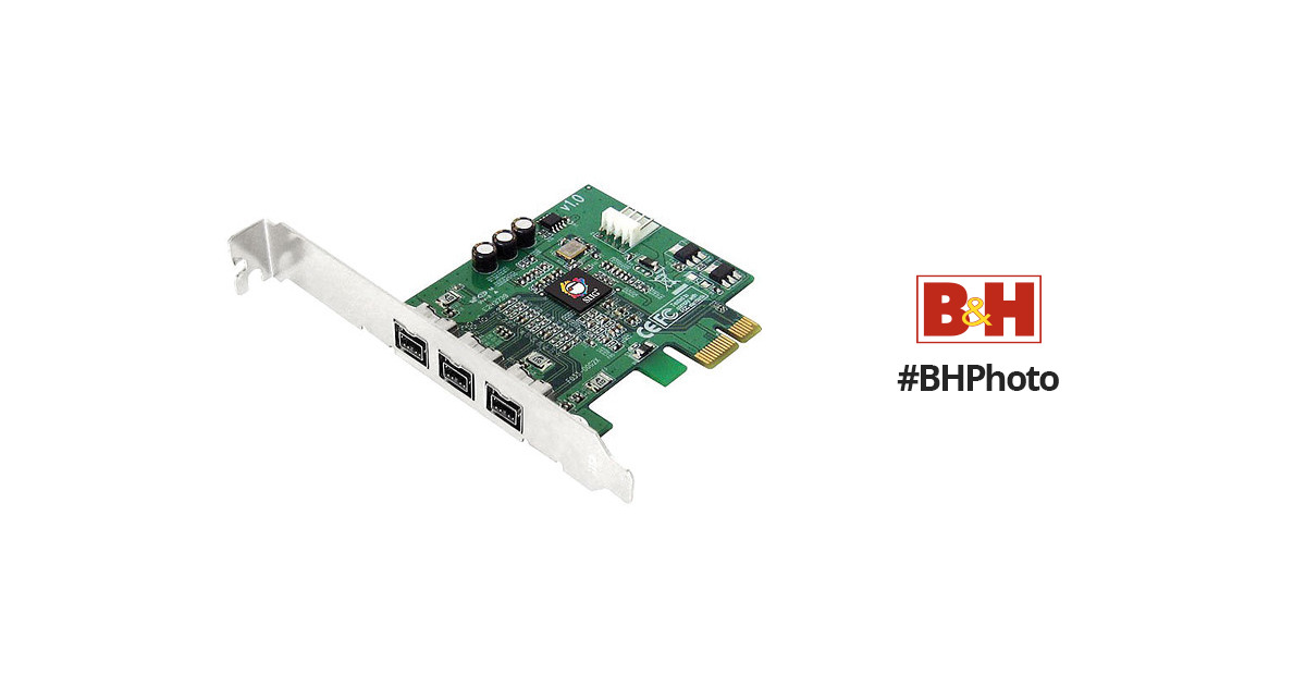

I just got one of these:
I installed it in my 2019 Mac Pro and it "just works". I attached my Gen 2 Drobo to one of the FW800 ports and it's working fine.

FYI - I have been giving this card a workout the past couple days with about 12 of my old Firewire G-Drives - has not missed a beat...

I have been using the one I mentioned in Post 11 for almost 2 years without issue.

Hi, I'm running Big Sur on a MP 5,1 installed using OpenCore. Since the upgrade, I've been having random issues with my FW FireFace 800 which sometimes works but mostly not. I get digital feedback or glitchy audio. After further investigation and options, it was suggested I try the following FWcard from star Tech:
StarTech.com 3 Port 2b 1a 1394 PCI Express FireWire Card Adapter - 1394 FW PCIe FireWire 800 / 400 Card (PEX1394B3)
I bought the card from amazon and installed. Although the Mac can see the card in system report, the FF800 doesn't, as the host light stays red. AFAIK, there are no additional drivers required to use this card so I'm assuming the issue lies with the FF800 as others have posted above that the card works out of the box?
Would be grateful for any insight or pointers,
