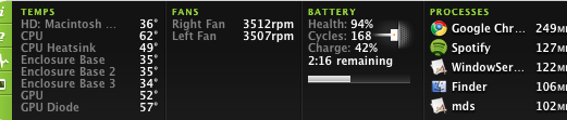

Right now I have the Steinberg MR816 firewire interface connected. And my fans are running at 3500rpm (I have Spotify and Safari open).
If I'm mixing music on Reaper and have 20 tracks or so the fans will hit 5500rpm (Reaper's performance meter says it uses 10% CPU). I don't have the same problem with USB interface..

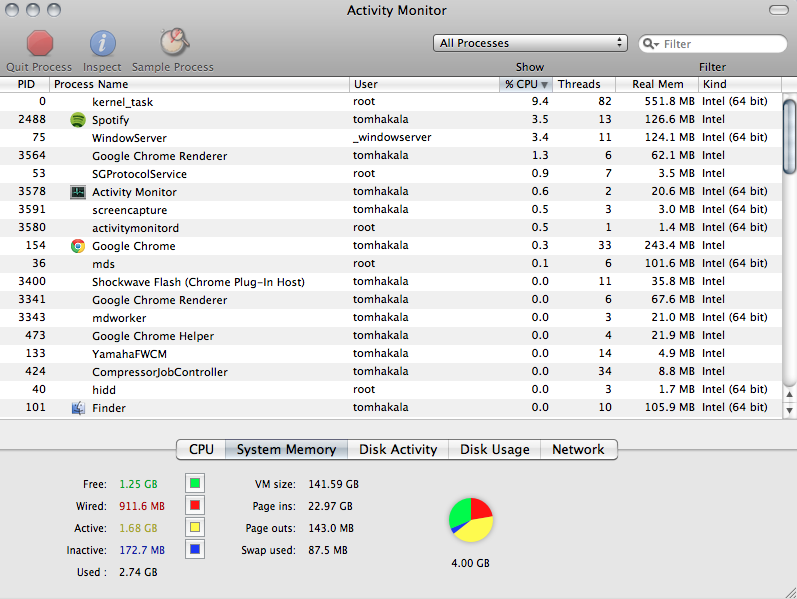

Have a look at Activity Monitor (Applications / Utilities /) and select All Processes and sort by CPU to see what the culprit may be.
Also check the "System Memory" tab to see what your "Page ins:", "Page outs:" and "Swap used:" are.
image below uses sorting by CPU as an example

Why does firewire make the fans work harder? I do understand if I use Lightroom and the fans goes up (the activity monitor says LR uses 79% CPU). But if I have Firewire and there's no sings of heavy CPU usage but the fans go faster.

also, it would be more helpful to post a screenshot of activity monitor while you have a project open in reaper.
I could do that (my friend has this same MBP and I can also post Activity monitor shots while I'm running Reaper).. but I dont need to be runninging Reaper and my fans go to 3500rpm. I can see same kinda behavior on my RME Babyface USB interface. But it's not that bad at all.
