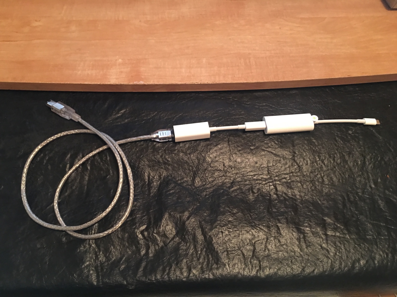

UPDATE (May '19): I tried the three cables — They didn't work.
I spent $80 on..
* FW400 to FW800 cable (4+ star reviewed on Amazon),
* FW800 to TB2 cable (Apple), and
* TB2 to TB3 cable (Apple).
Mac OS (Mojave) didn't detect anything on either TB port and the Presonus Firestudio Mobile's indicator flashes red and blue - meaning no signal is detected. (I do have the Presonus Universal Control app running, btw, and I also have it powered using the power supply.) Without the Presonus power supply the FireStudio was dark (no power or flashing indicator). System Report showed nothing on either TB port with the three cables connected and the audio interface powered using its power cord.
Next I tested the FW-only adapter cable on my old iMac, which has FW800. It recognized the FireStudio right off, so that cable's fine. It's running El Capitan, btw.
I then tested the set-up with the next cable (FW400 > FW800 + FW800 > TB2) with my wife's 2013 MacBook Air (Mojave). The FireStudio drew power but that's it - it wasn't recognized by the Mac (though the first cable, FW800 to TB2 was, according to System Report) - even with the Presonus drivers installed.
I haven't tested the TB2 to TB3 but I suspect that's not the issue (given the test just above). Then again, it may be dead.
Very disappointed that this didn't work. At least I can return the cables and save up for a replacement audio interface.
I am bummed out to hear of your experience. That being said - it had been a couple months since I had last recorded so I wasn't sure if a recent update had locked things out. I tested my rig this week after reading about this and my Presonus unit works with no issues. Linked right up, solid blue light, and showed up in the OS and in Logic as it always has for me. While getting an audio interface with modern connections is probably the best way to go overall, it may be possible to get this one going yet.
Just to compare, I am using a 2016 13" MacBook Pro (Touch Bar). I tested it with the latest version of Mojave this week. Connections were: MacBook Pro->Apple TB3 to TB2->Apple TB2 to FW800->FW800 to FW400 cable->Presonus Firestudio Tube. I did install the Presonus Universal Control software when I bought the computer but haven't touched it since.
