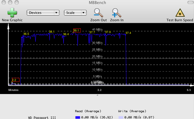

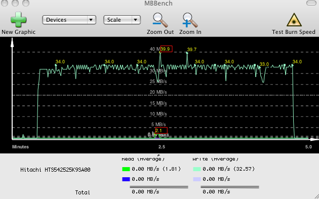

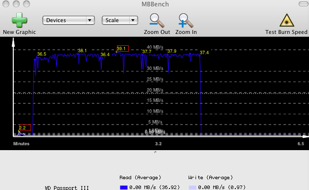

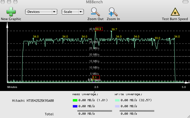

I just did a test USB v FW400
Same Hard drive. WD passport hard drive w/ USB 2 and FW400
The USB was not that far behind FW400 and the transfer speed was still high.
