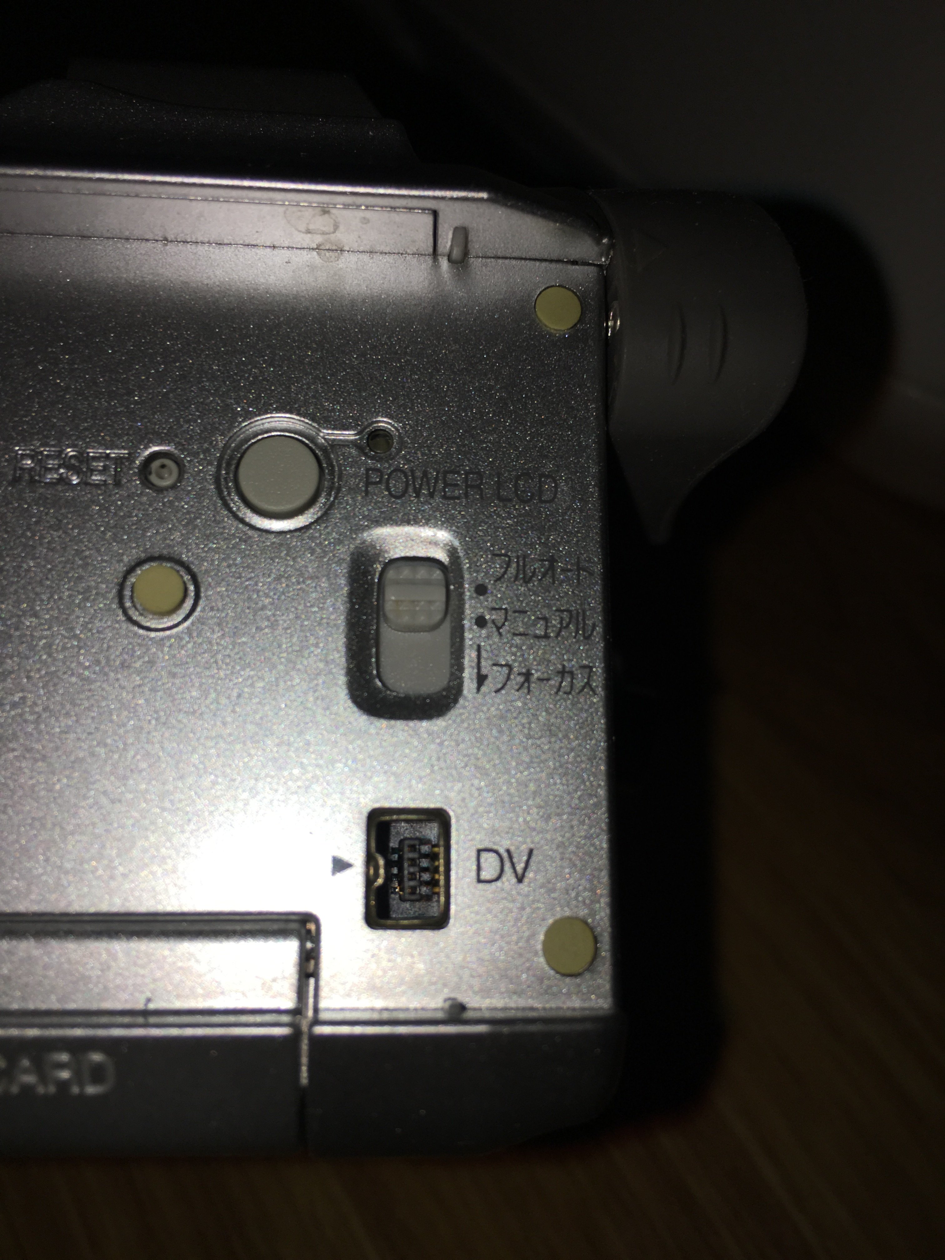

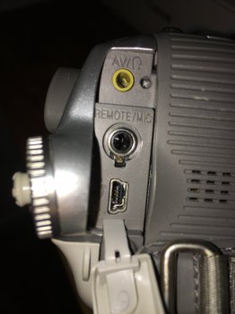

I’m attaching two pics from the camcorder. Can you tell what the ports are? What is the one below the “remote/mic” port and what is the “DV” port?
Also, I believe I transferred from it to a 2004 PowerBook. Would that have been FireWire 400 then?

The DV port is that - your FireWire port, but it's the micro/mini form factor (not sure about the exact names for them). I had a cam like this too. Another adapter or special cable (ie micro FW to FW400) may be needed. Or an adapter plug. The port below the Microphone port appears to be a mini USB connector.
I see. So, for the firewire cable, I should probably first look for a micro FW to FW800 cable? That would then mean I could try to go from the camcorder to the thunderbolt adapter on the Mac? Is micro FW only FW400?

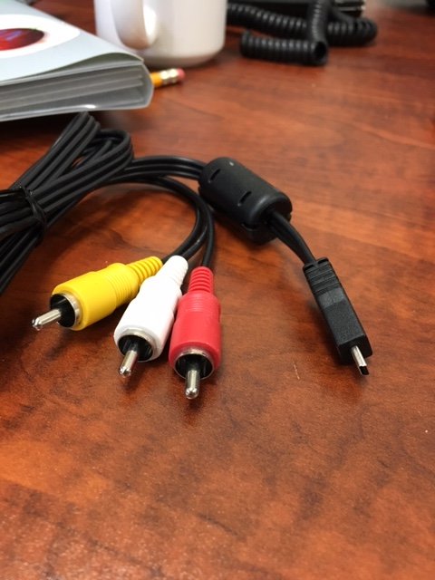

For the possible mini-USB connector, I found this cable (attached). Would that port also carry audio and video so I could connect it to my TV (if it fits)?

I understand. Thanks. For the firewire though, I'm still a little confused. I'm not sure what microfirewire is. Are you able to tell from the camcorder pic of the "DV" port if that is a firewire 800 or is that a "microsfirewire" connection?
if it's a microfirewire, I will need to get a microfirewire to firewire 800 cable and then connect that to the Thunderbolt adapter?
Can you post the exact model of the DV camcorder?
If we have a model number and manufacturer, we can search the web for user manuals. When trying to learn about connectors on electronic equipment, it's much more accurate (and often simpler) to work from the manufacturer's data, rather than guessing based on what a connector looks like.
Sony called their interface i.LINK. TI called it Lynx. The i.LINK connector is smaller than either FW400 or FW800 connectors, and also has fewer signals on it.
