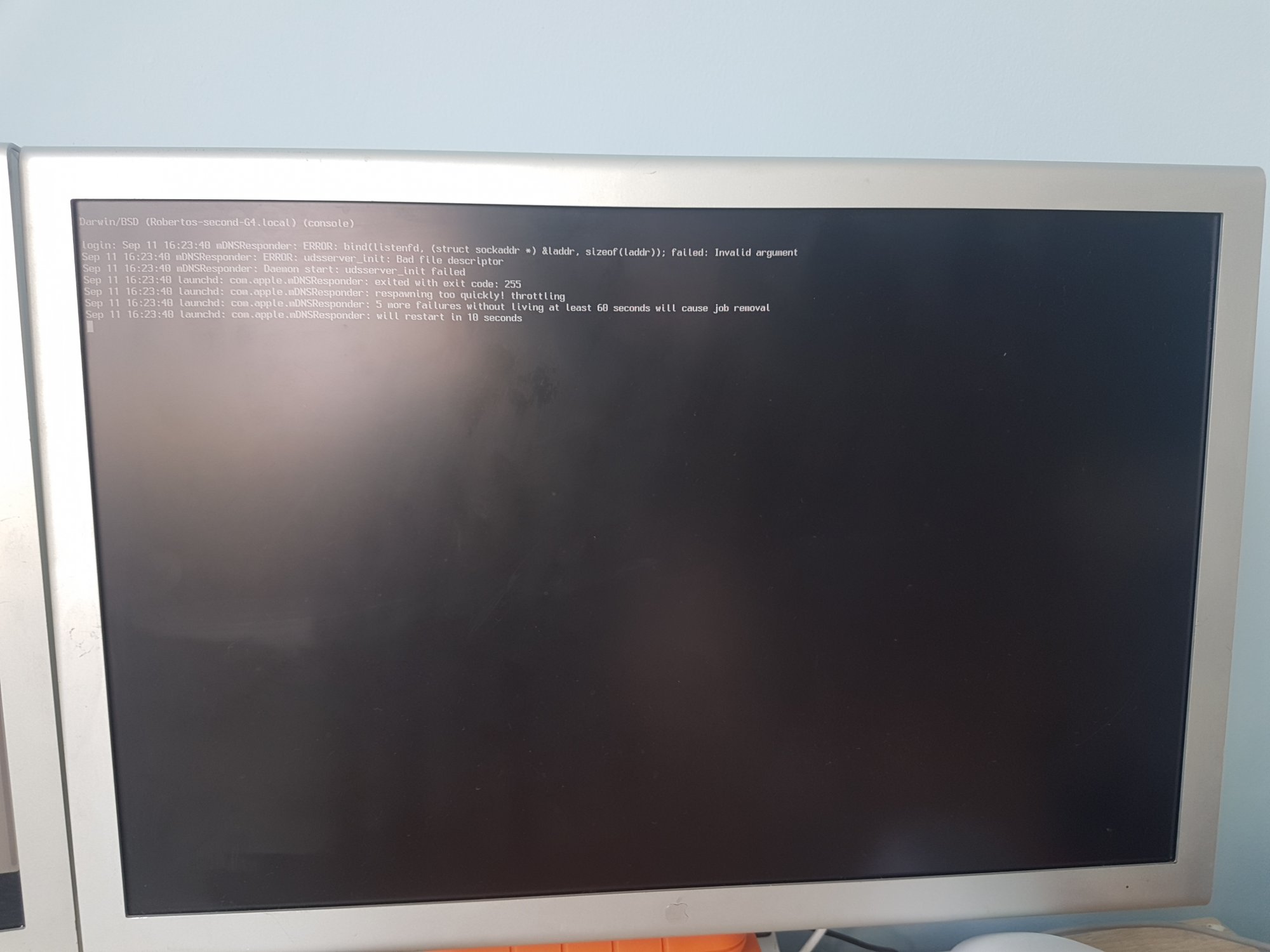

Here is the picture I get when trying to boot from the SSD plugged into the SATA Card. The same drive (Samsung EVO 850) boots fine into OSX using a IDE-SATA adapter.

There's no panic on that screenshot, but if you leave it there for a while, does a panic call trace eventually appear? There's also nothing on-screen that mentions the pci card driver, but if you're absolutely certain the system on the SSD isn't bricked, the link between the SSD and the card might be the issue. Try another and/or a shorter SATA cable or if possible, try to boot off something else in SATA (not an SSD). The usual.. I have two of these cards (Sonnet-branded two-port SIL3112) and OS X just works out of the box (my DA has one at the moment). I use spinners, though..
So you guys were right. I tried an old SATA spinner, cloned my Tiger install onto it, and it booted just fine (using the same SATA cable I was using before). So either the PCI SATA card doesn't like the Samsung SSD, or there is something wrong with the SSD. One indication that it might be the latter is that my Jaguar partition seems to have got corrupted, and I can't successfully repair it with either Disk Utility or DiskWarrior. I just didn't think of testing this as I thought the SSD was fine, given it worked using the IDE controller.
