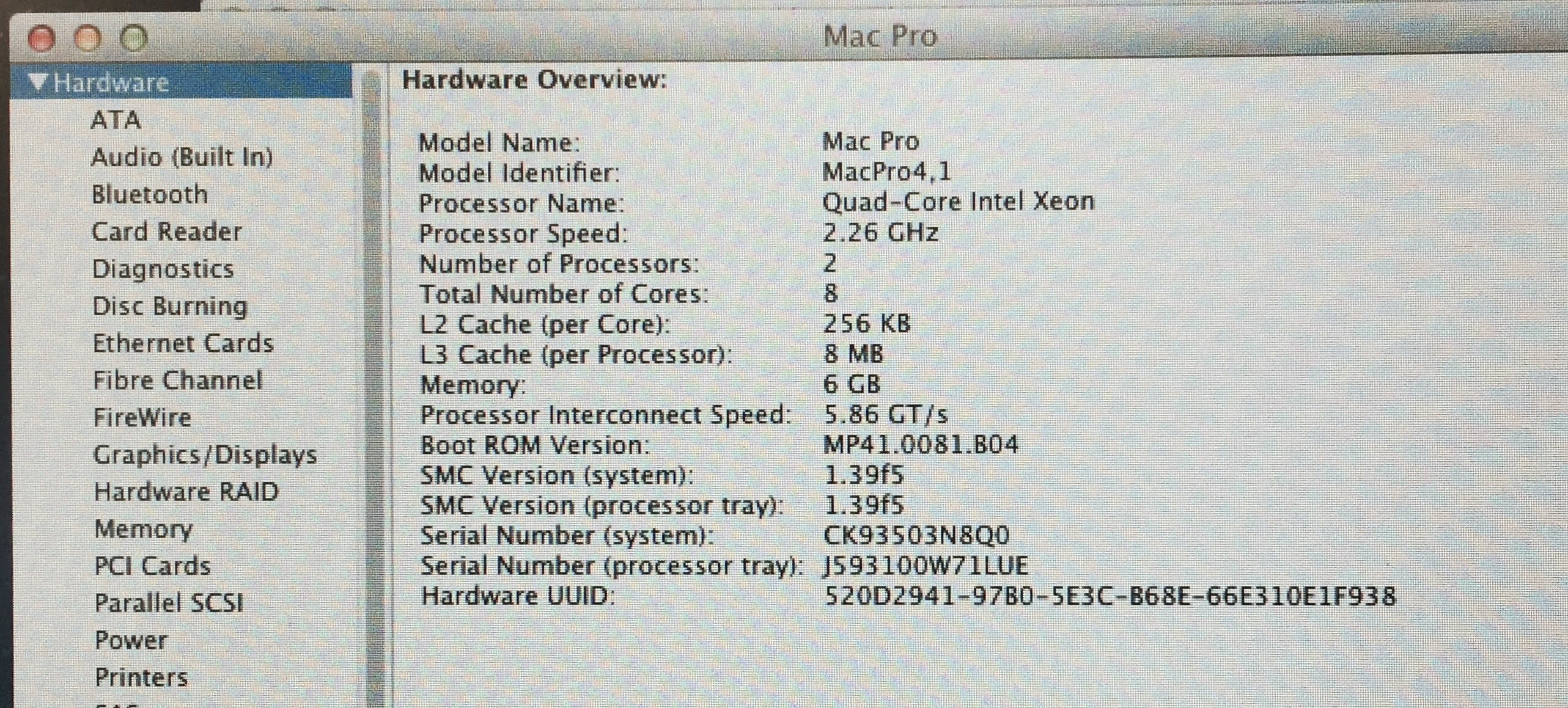

What's your firmware version now? I am wondering if your Mac has a custom firmare (which is possible for some refurbish machine) and cause this abnormal behaviour.
That's a good point - the 4.1 he is upgrading needs to have firmware ending in B07 I think. There were some refurbs or something that had B08.
yeeeeesssssss finally hapens thanks for all your help
this mac never has been upgraded so the rom boot end in B04 , now i did run software update and the firmware update is now B07 and it did the 4.1 to 5.1 as usual no problems
