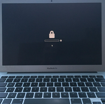

The login window for a firmware password is fairly disctinctive, where you get a blank box, with a padlock icon next to it. No title or other wording, just the blank box with a padlock. Is that the box that you saw? or did it have some text on that screen as well (again, the firmware password screen has no text at all, just the box and a padlock)
Thank you for the help. I don’t have a picture but it looked exactly like this.
If you “remembered” the password, obviously you set it. I can’t say what the exact combination of steps was from booting without to booting with - but I’m confident it was user behavior.

OP wrote in reply 8 above:
"I don’t have a picture but it looked exactly like this."
If you remembered the password, then I would advise you to DiSABLE the firmware password so it won't bother you any more.
