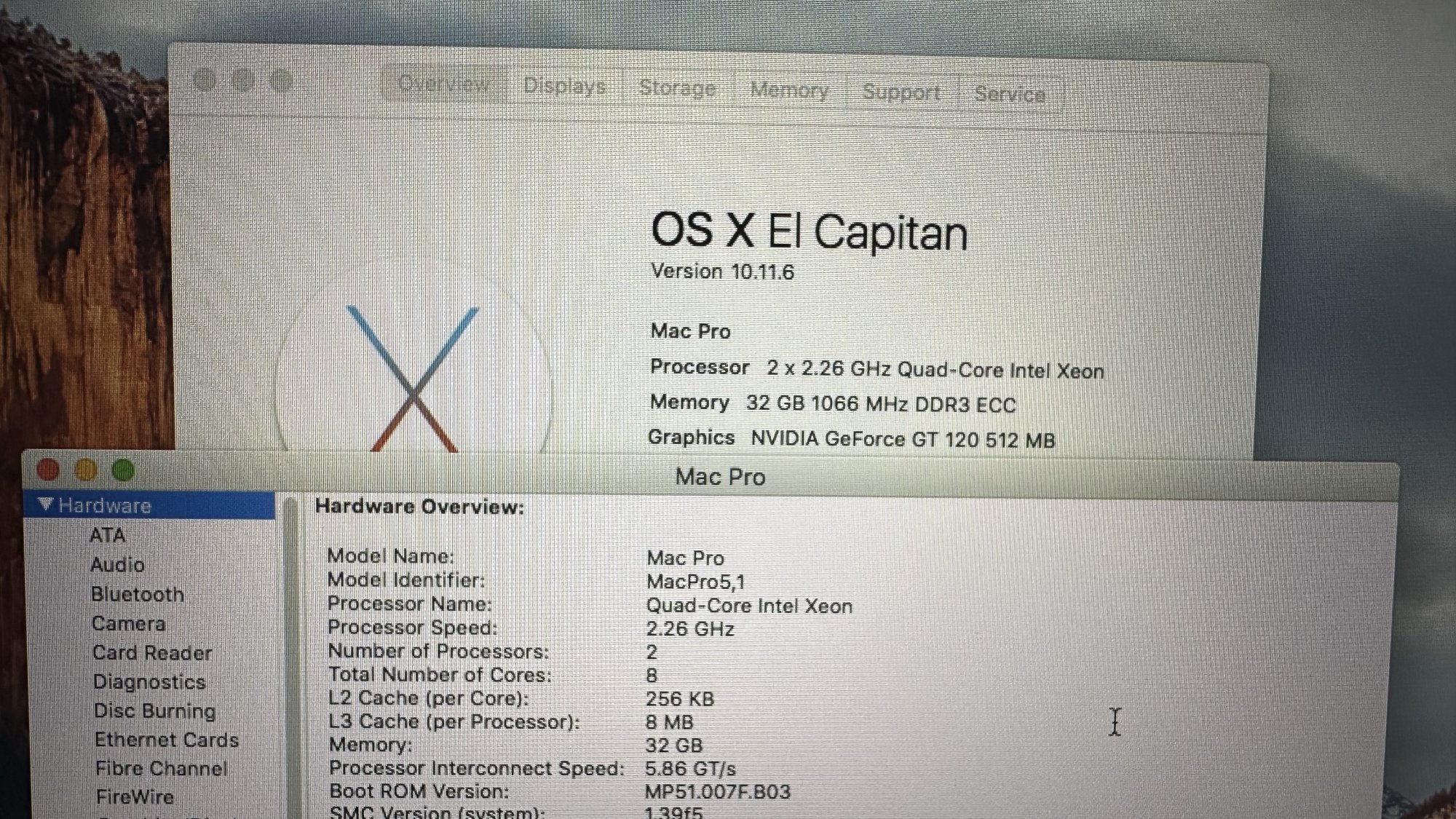

Hello and thank you for your way to solve 5530 error problem.
I try to upgrade Mac Pro 4.1 to 5.1 and get error 5530. Sip disabled.
I did everything according to the instructions https://forums.macrumors.com/thread...1-to-5-1-upgrade.1752143/page-6#post-25570945 on Mac Pro (Early 2009) and get this in Terminal window:
Qs-Mac-Pro:~ Q$ cd ~/Downloads/Mac\ Pro\ 2009-2010\ Firmware\ Tool.app/Contents/Resources/
Qs-Mac-Pro:Resources Q$ ./ExtractAndPatchEFIFiles.sh
/Volumes/RamDisk ~/Downloads/Mac Pro 2009-2010 Firmware Tool.app/Contents/Resources
hdiutil: detach failed - No such file or directory
patching file /Volumes/RamDisk/MacProEFI2009-2010/EfiUpdaterApp2.efi
patching file /Volumes/RamDisk/MacProEFI2010-2009/EfiUpdaterApp2.efi
Qs-Mac-Pro:Resources Q$ sudo UpgradeEFI2009-2010.sh
Please, help me. What am i doing wrong?

I was able to upgrade it manually. Got the answer from forum.Netkas.org. Instruction below.
Started by MacEFIRom, Message by verveguy
Relevance: 63.9%
I could not get the firmware updater tool to work. Error 5570 then Error 5530.
So I hacked the scripts within the tool and ran them directly. I now have a MacPro 2009 which reports Model Identifier: MacPro5,1
Root problem: you need to have BOTH the 2010 and 2009 EFI upgrader disk images available so this tool can prepare both the upgrade and downgrade paths. And the tool no longer seems to be capable of downloading them (or at least not for me and anyone else getting the 5530 error). Digging into the compiled .scpt file inside the tool, it's pretty clear what is wrong. But the script is run-only compiled and I can't fix it directly.
So I manually downloaded them and then had to hack the subsidiary shell scripts embedded in the Firmware Tool app and run them directly by hand.
Here's what I did:
0/ Reboot in recovery mode and disable SIP (Recovery mode, Terminal, csrutil disable ). Reboot again.
1/ Download *both* EFI updater packages from Apple
https://support.apple.com/kb/DL989?locale=en_US
https://support.apple.com/kb/DL1321?locale=en_US
2/ Use DiskUtility to convert each disk image to a new read/write image
3/ Mount the first image for the 2009 firmware. Rename the mounted disk to Mac Pro EFI Update 2009
4/ Mount the second image for the 2010 firmware. Rename the mounted disk to Mac Pro EFI Update 2010
5/ Run the netkas forum Mac Pro 2009-2010 Firmware Tool.app
(it will fail, but it will create the RamDisk)
6/ Hack the ExtractAndPatchEFIFiles.sh script buried in my ~/Downloads/Mac Pro 2009-2010 Firmware Tool.app/Contents/Resources/ directory with this new version:
Code:
#!/bin/sh
pushd /Volumes/RamDisk
# we mounted the EFI update disk image manually
# hdiutil attach -nobrowse EFI2010.dmg
pkgutil --expand '/Volumes/Mac Pro EFI Update 2010/MacProEFIUpdate.pkg' Expanded
cp Expanded/MacProEFIUpdate.pkg/Payload Payload
tar -xf Payload
mkdir MacProEFI2010-2009
mkdir MacProEFI2009-2010
cp 'System/Library/CoreServices/Firmware Updates/MacProEFIUpdate15/EFIUpdaterApp2.efi' MacProEFI2010-2009
cp 'System/Library/CoreServices/Firmware Updates/MacProEFIUpdate15/MP51_007F_03B_LOCKED.fd' MacProEFI2009-2010/MP41_0081_07B_LOCKED.fd
rm -R Applications
rm -R Expanded
rm -R System
rm Payload
hdiutil detach '/Volumes/Mac Pro EFI Update/'
# hdiutil attach -nobrowse EFI2009.dmg
pkgutil --expand '/Volumes/Mac Pro EFI Update 2009/MacProEFIUpdate.pkg' Expanded
tar -xf Payload
cp 'Applications/Utilities/Mac Pro EFI Firmware Update.app/Contents/Resources/EfiUpdaterApp2.efi' MacProEFI2009-2010
cp 'Applications/Utilities/Mac Pro EFI Firmware Update.app/Contents/Resources/MP41_0081_07B_LOCKED.fd' MacProEFI2010-2009/MP51_007F_03B_LOCKED.fd
rm -R Applications
rm -R Expanded
rm -R System
rm Payload
popd
patch /Volumes/RamDisk/MacProEFI2009-2010/EfiUpdaterApp2.efi EfiUpdater2009.patch
patch /Volumes/RamDisk/MacProEFI2010-2009/EfiUpdaterApp2.efi EfiUpdater2010.patch
7/ Then run the script directly. Using terminal:
Code:
./ExtractAndPatchEFIFile.sh
8/ Shutdown then power on and hold down the power button. Don't let it go. You'll hear the beep indicating EFI update, then it will reboot again. Keep the button down. In my case, the CD drive popped out. I waited a while, then pushed the CD drive back in. Eventually, I got bored and let the power button go. A little while later it rebooted again. Maybe even one more time.
9/ Login, check all is well with System Info.
10/ Reboot into Recovery mode again, enable SIP (Terminal, csrutil enable). Reboot
I'm pretty sure I captured all of that correctly. Hope this helps others.
(If anyone knows how to contact the original author of the update tool or can get the source, I'd happily fix it)

The method you quoted - the one outlined by Diepstor in post #141 - worked fine for me.
But... there are a few small caveats which need to be addressed.
1) Diepstor (or verveguy, it isn't clear which) made a small mistake in unmounting the volumes:
The first hdiutil detach '/Volumes/Mac Pro EFI Update/' should be hdiutil detach '/Volumes/Mac Pro EFI Update 2010/'
and the second should be hdiutil detach '/Volumes/Mac Pro EFI Update 2009/'
This caused the issue
But it isn't harmful to the process, just untidy.
Secondly, when specifying the final command, it should be sudo ./UpgradeEFI2009-2010.sh - note the ./ in front of the shell script name.
This caused Alex Rets' failure to launch in #167.
If you make those two changes to the instructions, it all works.

hi. thanks for the info. i would test it on monday and will give an update...

To the instructions:
0 - i installed mac os x 10.6. (so there is no SIP to disable)
1 - downloaded the two firmware updates and transferred them to the desktop.
2 - converted the two dmgs as read/write (as instructed).
3 - mounted image and renamed to ... 2009. (firmware 1.4)
4 - mounted image and renamed to ... 2010 (firmware 1.5)
5 - ran the Mac Pro 2009-2010 Firmware Tool (i got he 5530 error) (tool is on the desktop).
6 - edited ExtractAndPPatchEFIFiles.sh (see below) (right clicking on the Mac Pro 2009-2010 Firmware Tool > Show Package Contents > Contents > ExtractAndPPatchEFIFiles.sh)
#!/bin/sh
tar -xf Payload
rm -R Applications
rm -R Expanded
rm -R System
rm Payload
hdiutil detach '/Volumes/Mac Pro EFI Update 2010/‘
tar -xf Payload
rm -R Applications
rm -R Expanded

Hi guys, I have successfully upgraded my 4,1 to 5,1!
Relevance: 63.9%
Here's what I did:

This is working for me, I just have to change the script. Thanks for davidkfraser's advice.

After everything is done, shut down the PC, hold the power button, don't let it go EVEN you saw the flashes and the long beep, by keep holding the power button, the optical driver will come out indicate the firmware is valid, give like 5 seconds, push the drive back and another 5 seconds, release the power button and give it a sec, it will restart again and boot into OS X. Now it should be 5,1.
Same here 🥳 Worked like a charm as soon as I took the time and waited long enough! I now presume that for most people the procedure fails due to letting go of the power button too early. I ran into the same problem today, even though I already did this once 8 years ago. Please note that most descriptions/tutorials say that you just need to wait until the power button flashes or you hear the beep. No, that's apparently not enough! You ought to wait at least until the CD drive opens, which for me might have taken a minute or so. Heck, wait another 10 seconds if the progress bar of the firmware update doesn't show up yet.
So, thanks @jackma12138 for the reminder!
Cheers
Reactions: jackma12138
