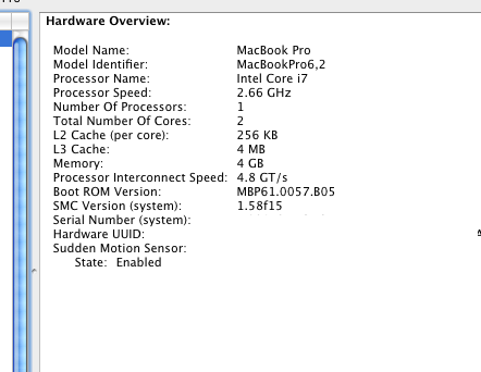

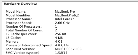

installed fine on my mid-2010 15" i7...
Spaces seems more fluent no more jitter. I have had the gfx update installed before today.

Looks like update only applies to those with 0057.B05 but not with B0A.
But I guess we will have to see.

On my 15" i7 MacBook Pro, the boot ROM went from version MBP61.0057.B09 to MBP61.0057.B0C. Curiously enough, the Nvidia GeForce GT 330M ROM also went from 3540 to 3560. My system also just booted after the update faster than it ever has before.
Looks like they only check the following
MBP61.88Z.0057.B00.1003040836
MBP61.88Z.0057.B05.1003191134
MBP61.88Z.0057.B07.1004071225
MBP61.88Z.0057.B09.1004161215
MBP61.88Z.0057.B0B.1007091039
Based on the script inside the update. (source)
