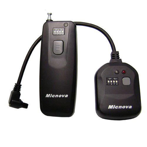

fwiw, I got this for $30, best $ for sharp pictures IMO (combined with decent tripod)
http://www.procameragear.com/catalog/product_info.php/products_id/422
Wireless remote shutter release
  • Line of sight range up to 100m (320 ft.) without obstacles.
  • 16 control output channels, dip switch selectable
  • Shooting modes:Single/Continuous frame shooting/Bulb
  • Low power provides long battery life
  • Works through walls and other obstacles using radio frequencies instead of infrared (RF - 433MHz)
  • Plug compatible with Canon RS-80N3 - Works on any camera that uses the Canon RS-80N3 remote
  • Two stage release. Halfway to focus, fully depress to release shutter
  • Battery life - Transmitter (1 year standby, 10,000 exposures)
  • Battery life - Receiver (1000 hours)
Compatible camera models:
Canon EOS 5D, 1D, 1D Mark II, 1D Mark III
Canon EOS 1Ds, 1Ds Mark II
Canon EOS 50D, 40D, 30D, 20D, 10D, D60, D30
Canon EOS 1V, EOS 3, EOS D2000

One question: Do you know if that would interfere with a Cactus transmitter and receivers, just in case I want to use it for strobist stuff?
Not exactly sure, depends on what part of the RF spectrum they use....
The unit I have is @ 433MHz. Somehow the DIP switches can be used also to help fine tune it if there is interference?? (mine are still at factory default)
[edit] hmmm, looking here http://www.mpex.com/browse.cfm/4,514.html I see they are at same RF: # Radio working frequency: 433MHz; need to be careful, good Q for others
