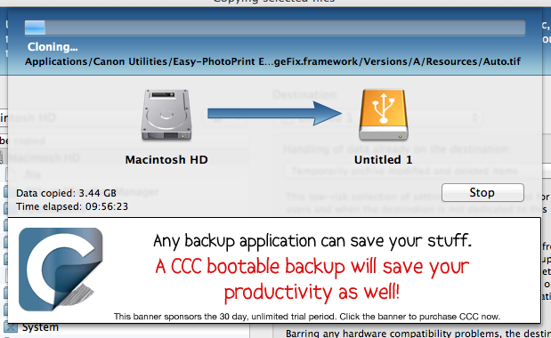

So I have a Time machine back up on my Time Capsule. I thought it would be prudent to make a bootable back up as well using CCC on a separate hard drive. It's been running 10 hours and has backed up only 3.44 GB so far. I know its on USB 2 but that is ridicules. Any suggestions?

Something's wrong.
The "normal" speed with CCC is about 1GB/minute.
Did you erase/format your external before cloning ?
(Mac OS extented journaled, GUID partition table).

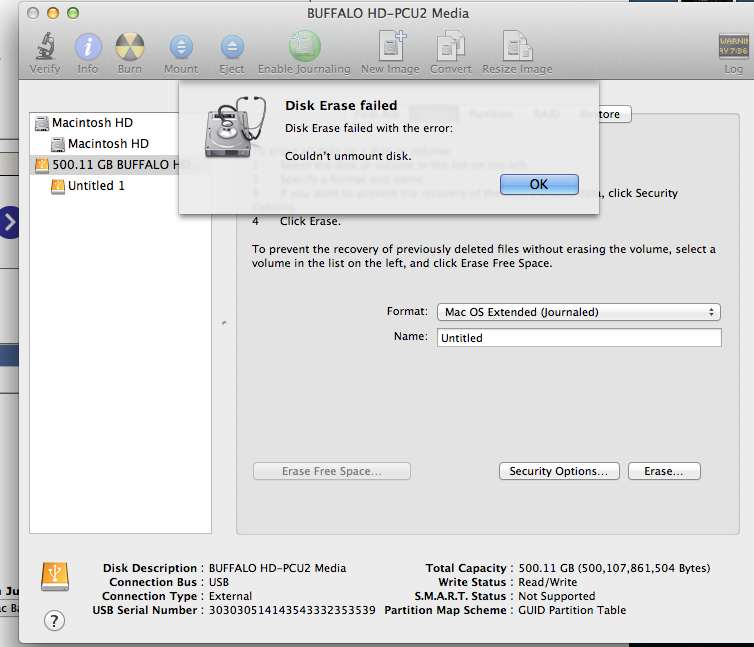

It says it won't repair. How do I go about reformatting and starting again? Or is there a problem with the drive?

Try this :
Select the disk (500.11 GB BUFFALO HD)
1. Erase tab, Erase
2. Partition tab : replace "current" with "1 partition"
Name the partition
Select "Mac OS extended (journaled)
Options : GUID partition table
Apply.
You should see the name of the partition just below the name of the disk.
Then try CCC again...

So I erased the partition, then tried to erase the HD itself. Got the following message.

Open the Terminal and run (safe) :
cd /Volumes/"Untitled 1"; ls -la
Enter.
If you get "no such file or directory", try :
cd /Volumes/Untitled\ 1; ls -la
Enter.
What do you get ?
EDIT : modified the second command. (deleted the ")
If you still get "no such file or directory", rename "Untitled 1" to "Untitled", and run :
cd /Volumes/Untitled; ls -la
