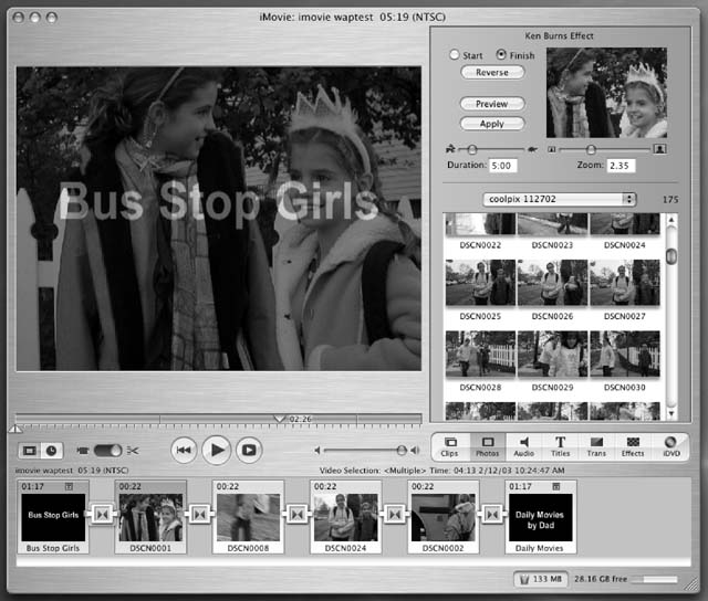

If your iMovie3 window looks something like this:
then click on the Clips button and it should show the Clip panel/viewer. Just drag your movie into it. That's how iMovie6 works and it doesn't look that different.

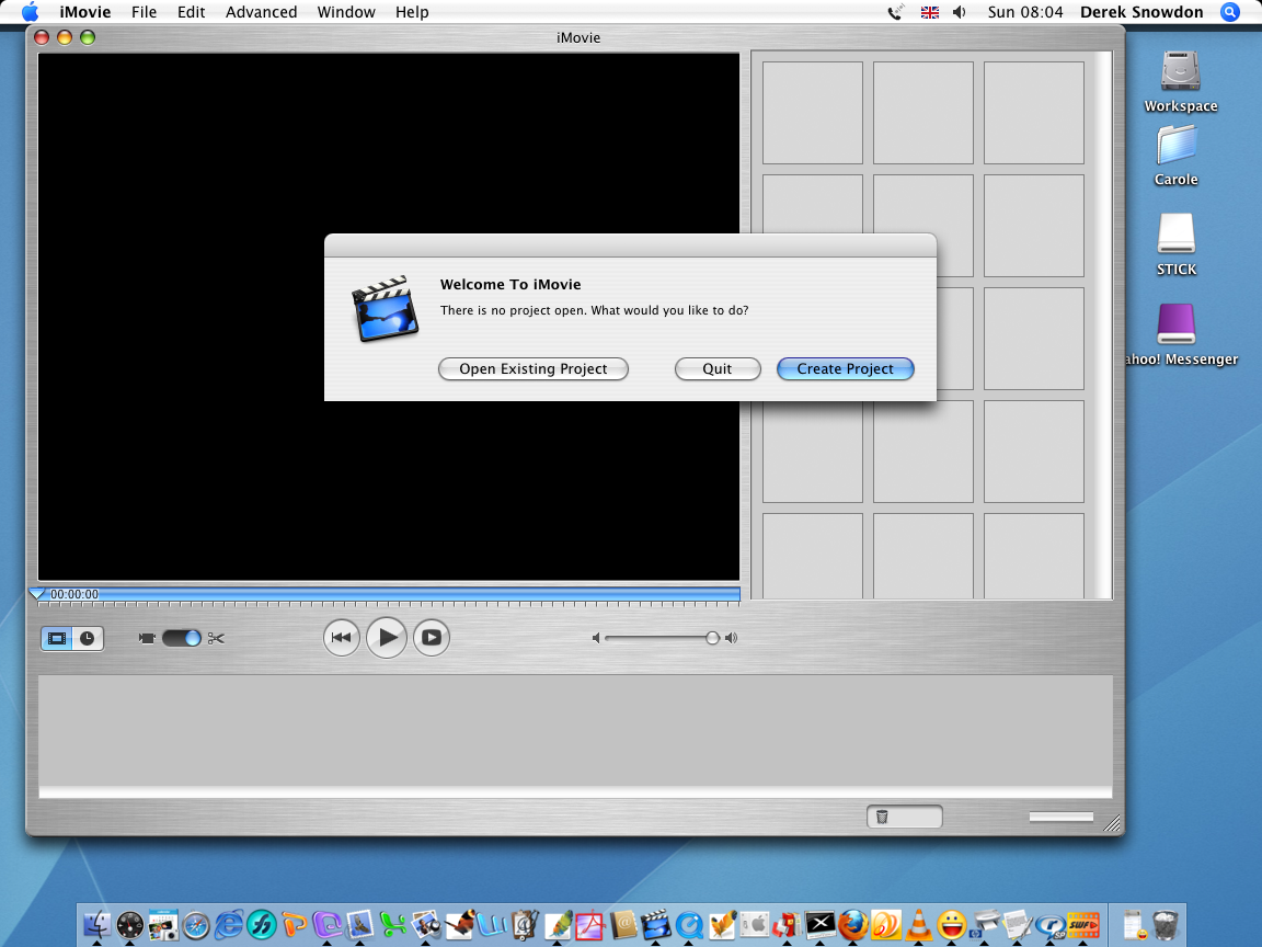

Thanks again Dave. Every time I open it I get those two prompts and can't get past them. Here is the screen shot. It only seems to want DIVX stuff if I try the Create option.

Create a new project and save it anywhere on your HD. iMovie doesn't open your video file directly the way quicktime does, it has to create a new file for a project that ultimately stores not only the video file, but also sounds, effects, etc. you might add. This file will have a different extension than common video formats, "filename.iMovieProj" if I remember correctly.
You can then edit your video, make cuts, add sounds, apply effects, etc. and export it as ".mov" when you are finished.
As for getting your video into that project file, you should be able to just drag it in there from finder, like another poster has already mentioned. Alternatively, you can import it directly from the camera.

Just click on "create project" in iMovie and choose the save location.
Then drag your avi file into the iMovie window.

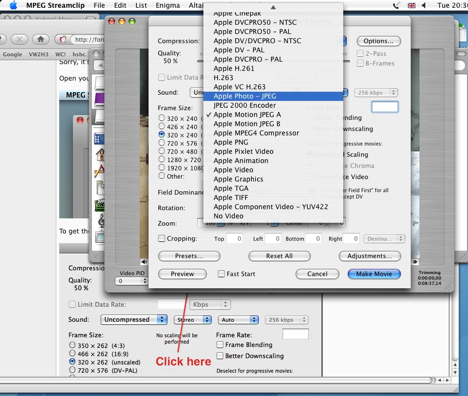

Open your .avi file with MPEGStreamclip. From the File menu, select Export to Quicktime:
To get the Apple Intermediate Codec,
then select.
Set the Frame Size and Quality slider to your preference. If vertical lines in your movie look jagged in the result, do it again but tick the "De-interlace Video" button.
Dave, the Apple Intermediate Codec is not listed as per this screen shot
