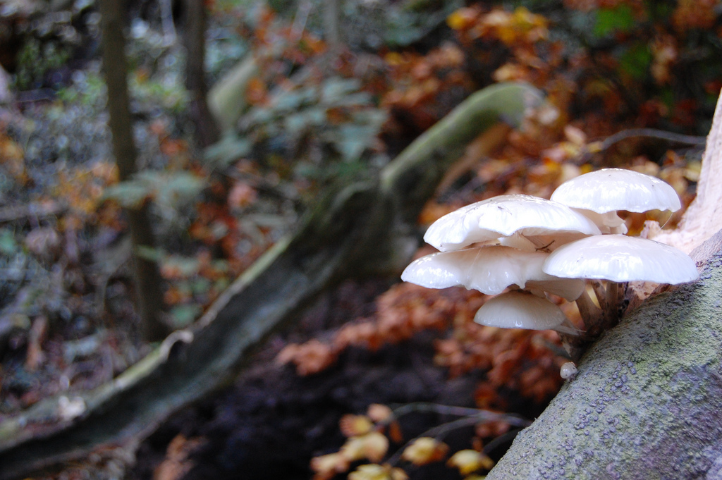

Hi guys , I got a D40 last saturday as I just started taking Photography at college , I come as a total noob ( I am a video camera geek).
I took the camera to the local woods today to try it out.
I was wandering if anyone could give me their opinions/advice? I know they aren't great as I was just testing it out and getting used to SLR cams.
They were all shot using either auto or macro settings.

In order to make #1 better, switch to manual (M) or "aperture priority" (A) mode, and lower your aperture as low as it can go (I believe it's F3.5) while keeping the autofocus on. I've taken "macro" shots like that with my D40 and it can definitely get some great close-ups with just the kit lens - it's a great camera. 🙂
1. Out of focus. Entire flower is not in the frame.

#1 is blurry and out of focus. Macro photography is quite difficult and you generally need a tripod. Using flash and a small aperture in this case would make the background go almost completely black, make this to make the flower stand up and be more attractive.

The D40 with kit lens is not great for close up work as the minimul focus distance is quite large. I guess this is the reason for failure in the first picture.
