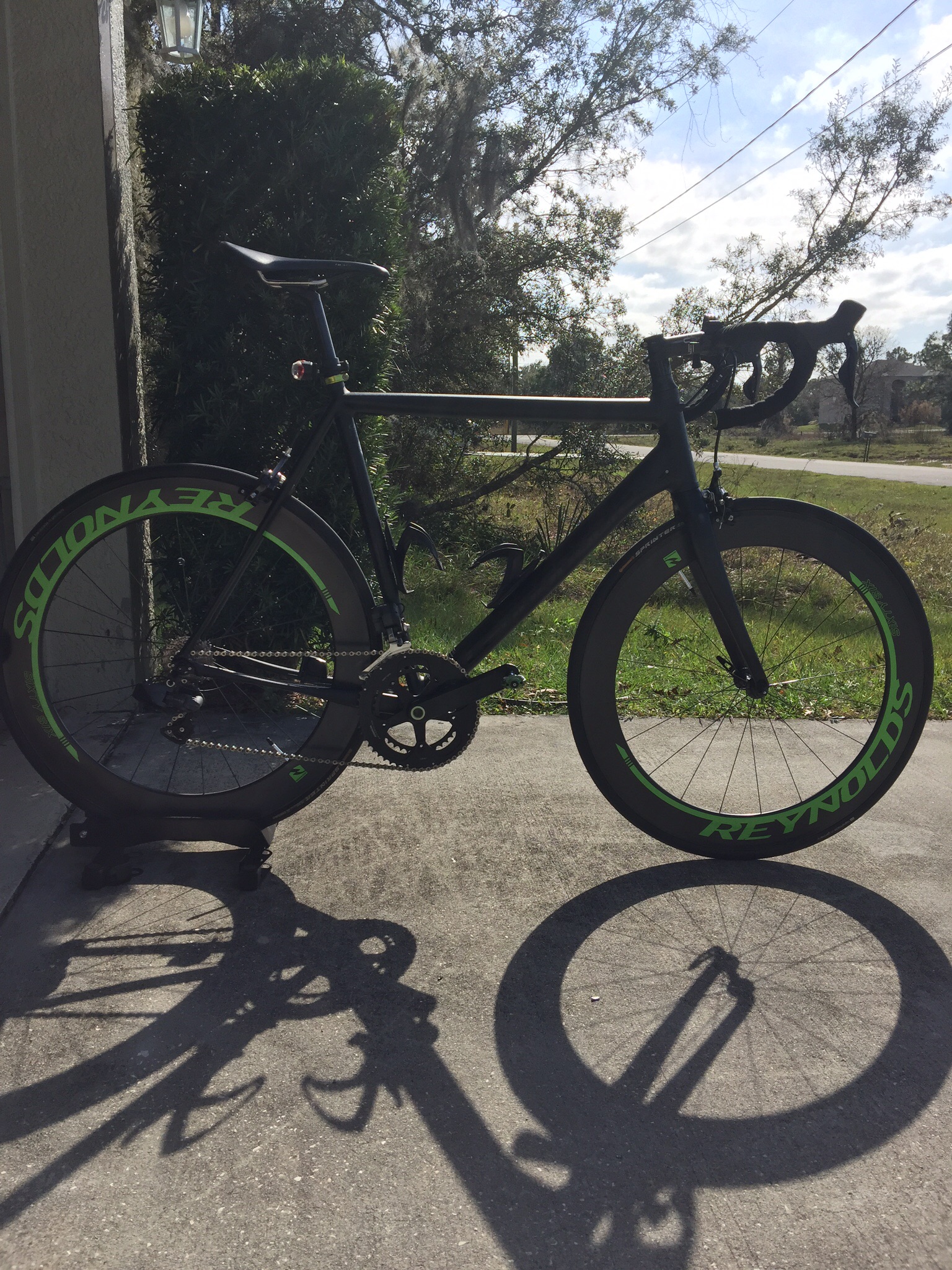

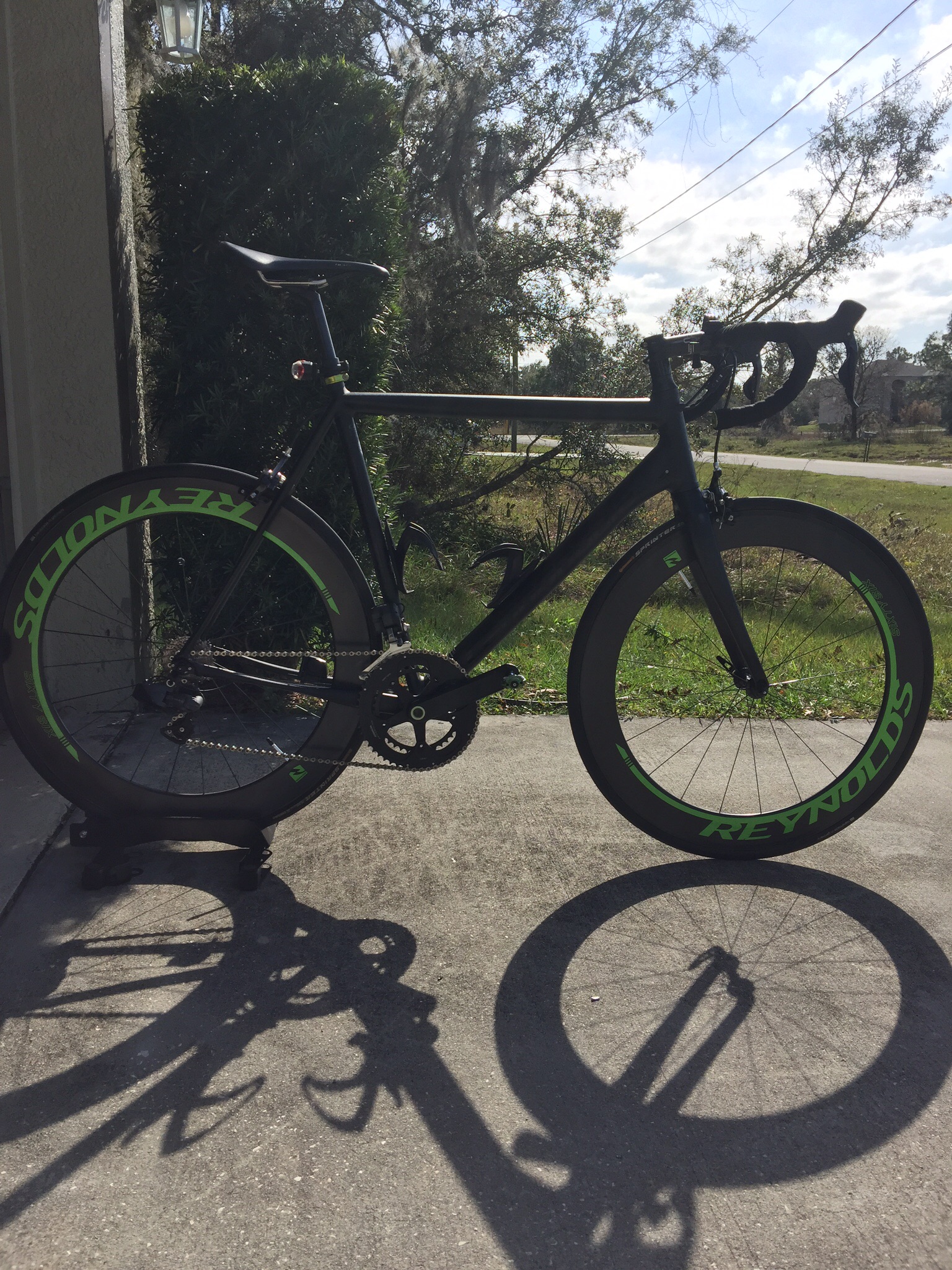

You sir should explain this to all the people on here who worried about the sport model, being scratch to death as soon as it come out of the package etc etc. I have been riding my 2014 CAAD 10 black anodized aluminum with carbon fork, I have put over 5000mi on it so far. And it's still looks new as the day I bought it, not a scratch or ding anywhere. I think it's ridiculous some of the the comments about the Aluminum not being durable enough for every day use. Here's is a photo of my bike, weighs 15lbs and is tough as nails. I will be buying the SG sport model on the 10th.
How about the close up and not against the sun... As someone who uses his bike year round, also in snow, it will corrode and gets dings.

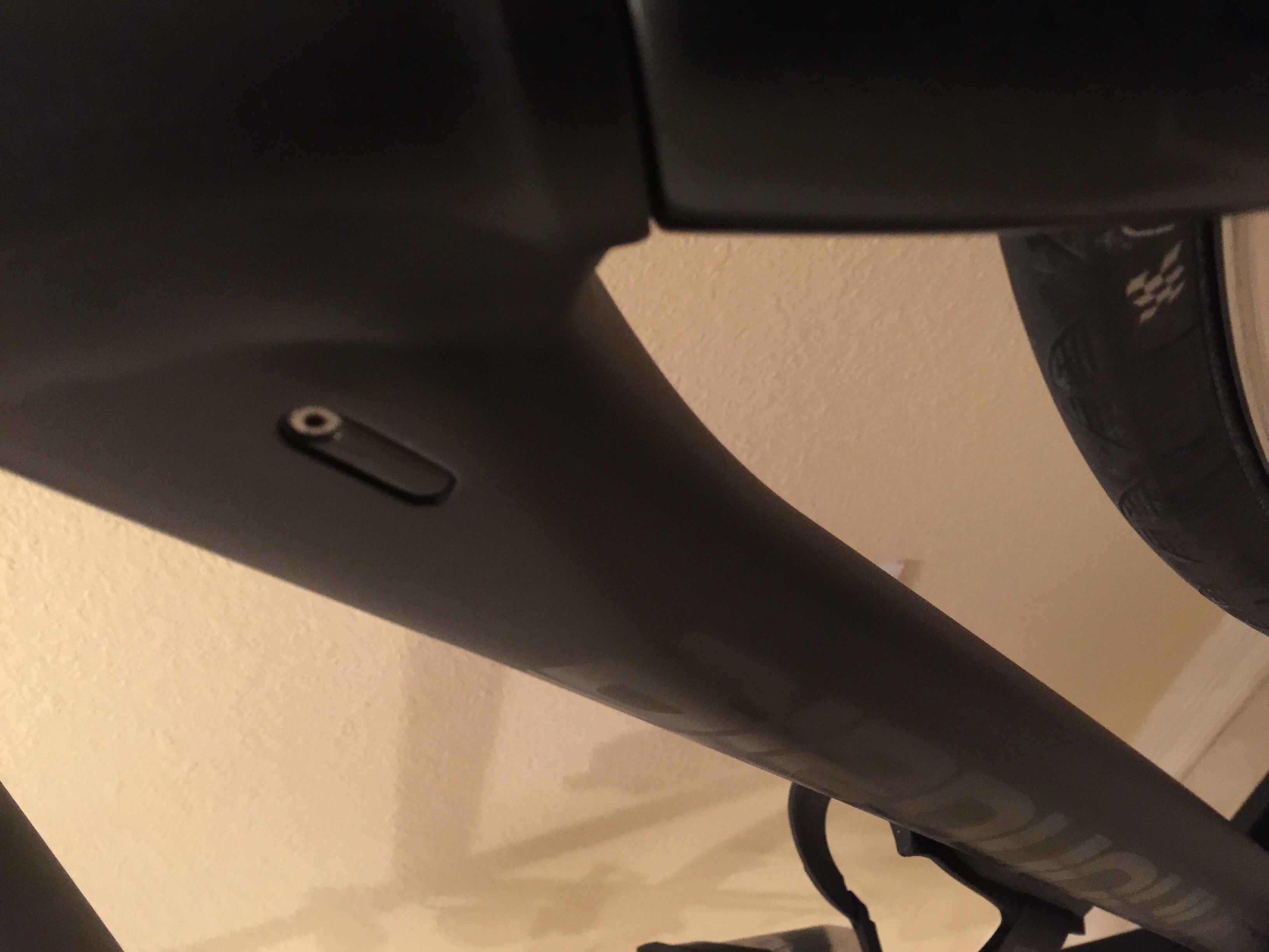

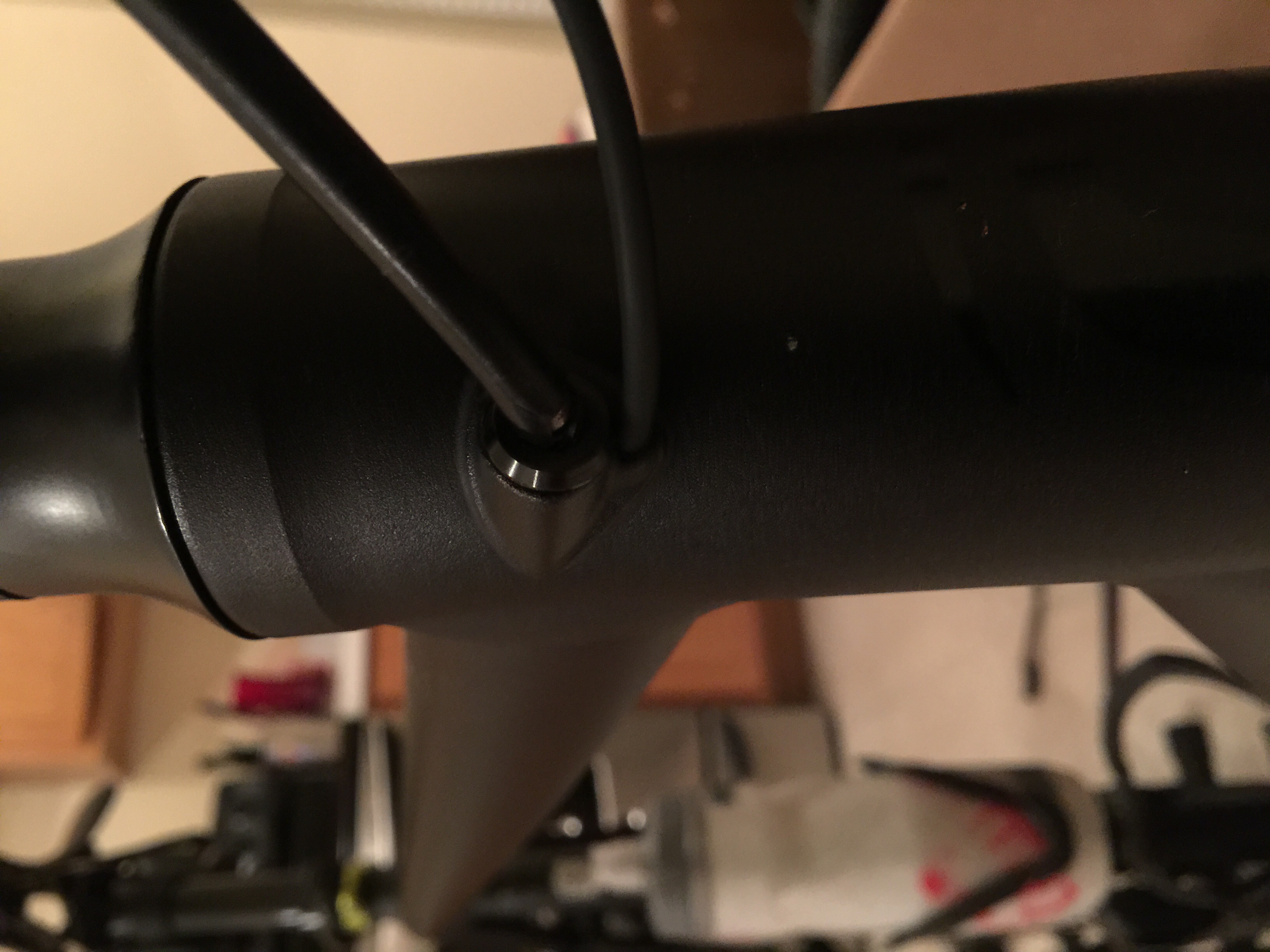

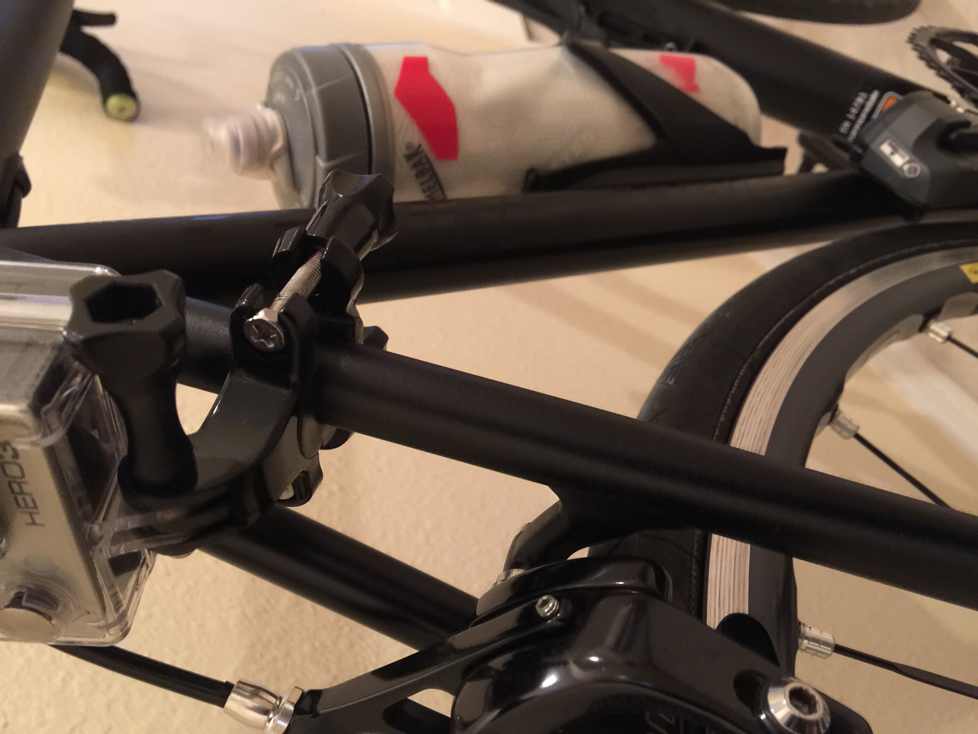

No snow here in sunny Florida, but we do have a lot of rain every other day or so. It would rain hard for a little and stop and then the sun would come out again. But I think sweat and sand is worse than snow. I sweat a lot when I ride and it gets on my bike. Here is a few close ups.

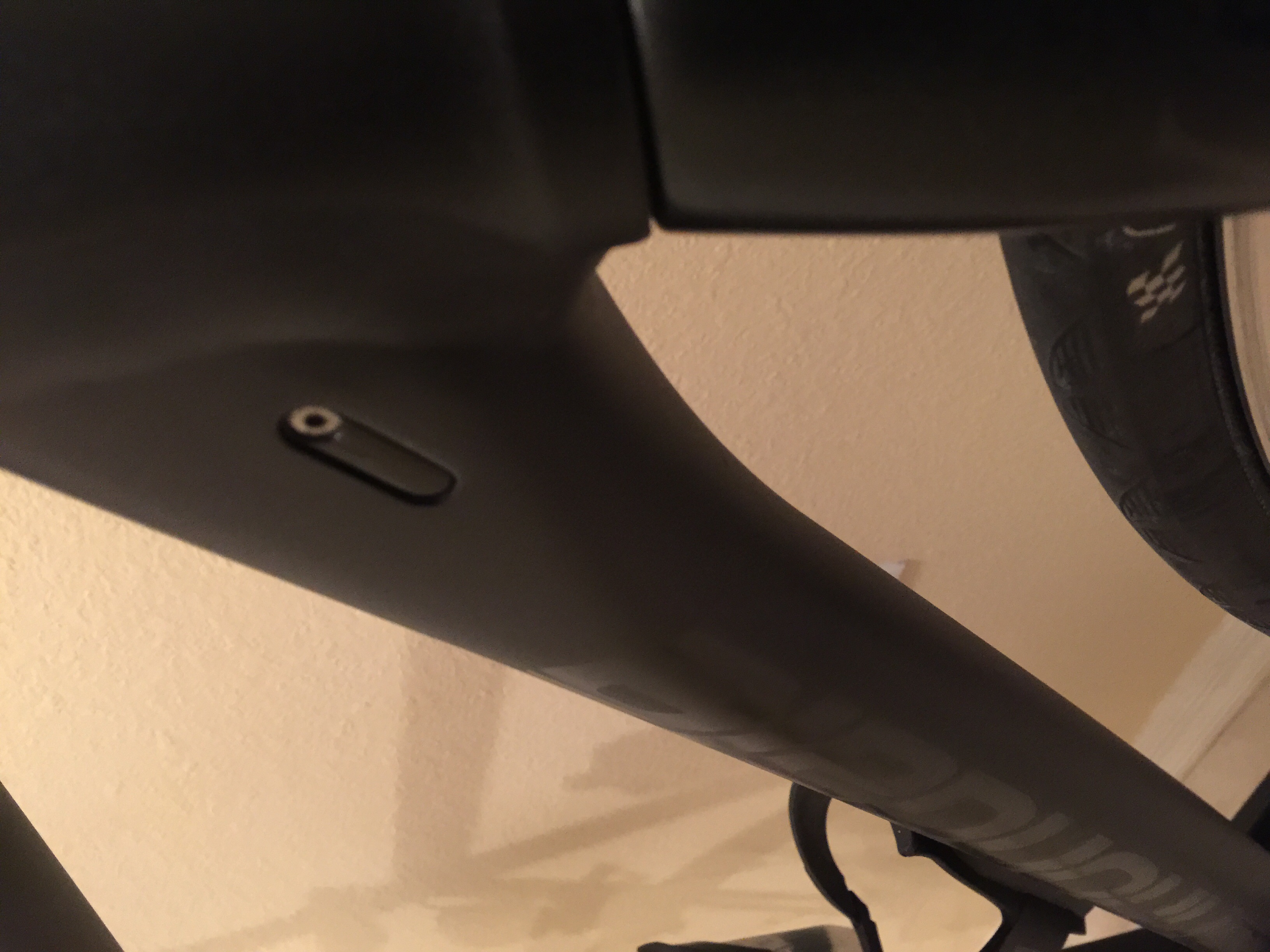

And also this is a $5000 bike, so would expect the finish not to easily scratch and ding up.

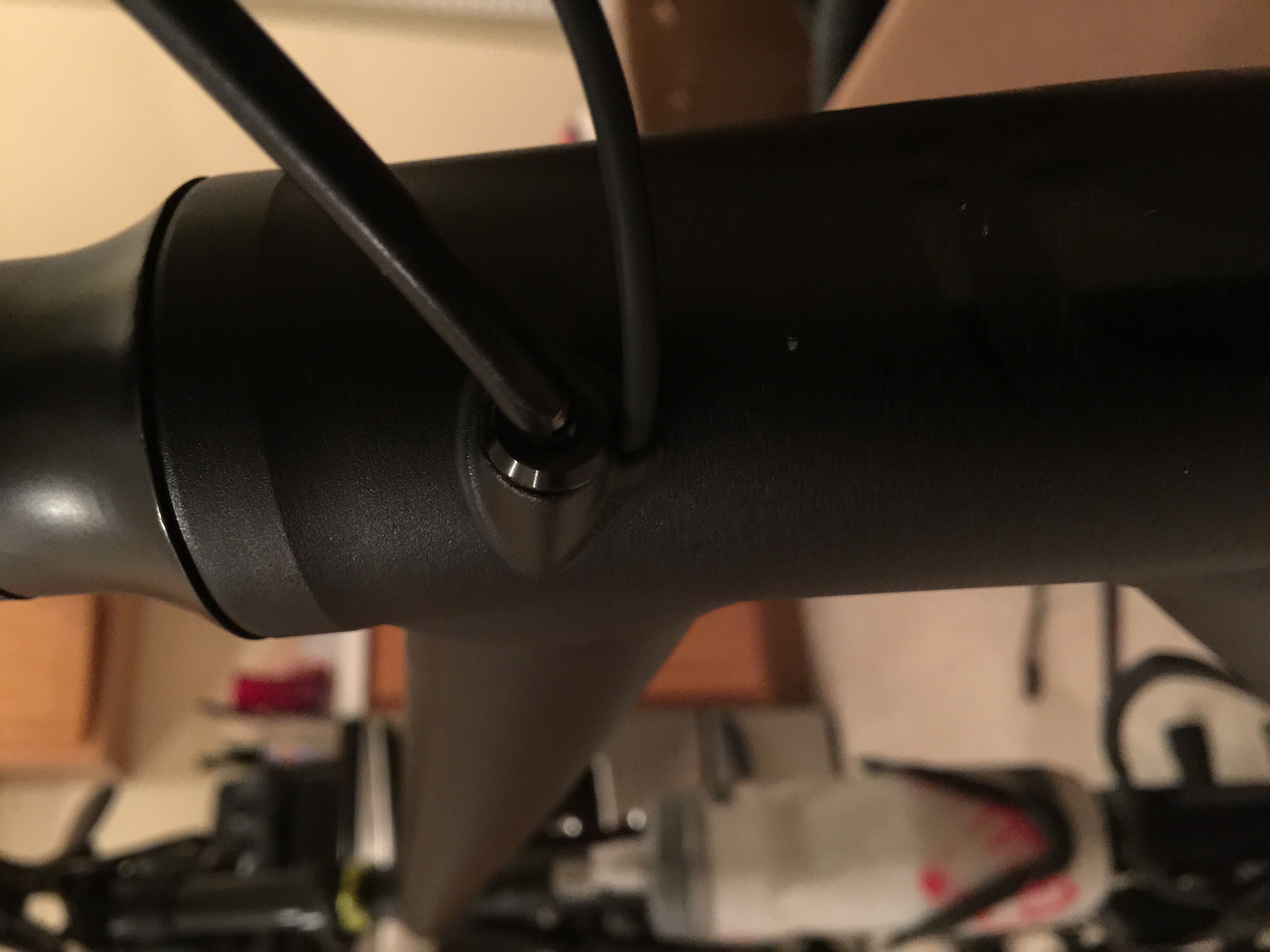

Don't know about trek, this frame is anodized aluminun with carbon fork. And only cables on this bike are the brake cables. The gear shifting is DI2 with the battery in the seat post. The brake cables and electrical wires are routed internally. For $5000 I would expect this bike to be free of corrosion, for a long time. Cannondale makes the best aluminun frames in the world, and if they can do such an amazing job with aluminum. I am sure apple can do the same with a watch made of aluminum, being the multi billion dollar company that they are. Having way more money than Cannondale.
