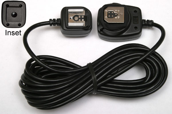

My second question is on the cord. I am going to do Pocket Wizards later, but for cost reasons and wanting to get going immediately, I am going to use a cord for now. I do want to retain TTL though, so from what I have read I need to use the type that hooks onto the hotshoe correct? The (is it called) "PC" sync port will not retain TTL right? If not, then my question becomes where can I find a long/cheap TTL cord? Most seem to only be a couple feet long and pretty expensive? Ideally I would have at least 10-15 feet, and I was hoping this wasn't going to be more that $20-30 tops but I may be way off base. Also, if using the hotshoe type cord, is the hotshoe stand adapter the correct type?

As for off-camera cables, Flash Zebra make them for MUCH less than the Canon OC-E3.
24 feet - http://flashzebra.com/products/0125/index.shtml
16 feet - http://flashzebra.com/products/0123/index.shtml
3 feet - http://flashzebra.com/products/0122/index.shtml
The 16 or 24 foot solutions will give you adequate reach and allow you to retain ETTL. That said, I would advise you to begin to learn about manual flash; ETTL is wonderful, and I use it quite a bit (especially with my new FlexTT5/MiniTT1 setup), but when you've got a static scene, manual flash can provide more consistent flash exposure control.

Lastly, you guys have me thinking about the ETTL thing. Long term I am getting PWs, so spending a lot on the cable pains me (can you tell I hate to rebuy things?). What do I need to do manual flash? How do you know what power setting to put it on? Is this a trial an error thing until you get the exposure you are looking for? I realize I just asked a question that probably entirely relies on an "it depends" sorta answer that would take pages of explanation... but I guess I am asking if I need light meters or other equipment? I am a complete noob at this as you may have guessed. I plan to do my homework but I want to have what I need to play around/practice as I learn...

Just get a cheap PC sync cord. You don't want TTL in a studio because you want to take a test exposue and adjust from there and TTL will be constant and you'll go nuts. This is actually good news as it means you canuse much less expensive equipment and actually get better result.
I've been looking at off camera cord.
Are you aware of anybody bought 24' cord, and modified the cord via male/female plugs (cut the stock cord, re-fit with plugs via solder) so you'd have say a 5' cord for hand held off camera shooting and then a 24' cord for longer off camera flash? (plug in the extra length cord you cut to make a 5' cord) Would save from buying 2 cords. I'm a DIY person so hoping others have done this.
I can't remember how many wires are in the TTL cord, but I think it is 5 or 6. For plugs you would probably be looking at Lemo or XLR5 (neither of which are very cheap and lemo is small so soldering the plugs is a b!tch). You would probably be looking at ~$25 for the plugs, plus your time to put it together.
