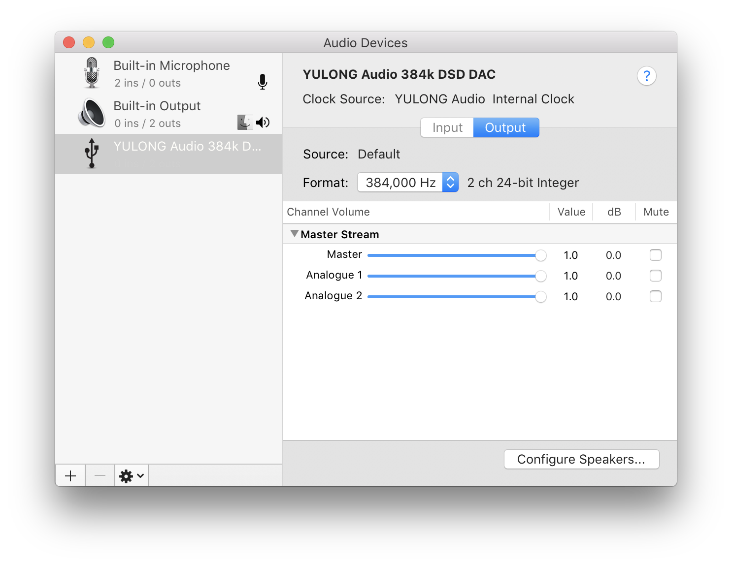

I have a MBPTB 2016 model and also feed my DAC via USB, and I confirm that yes, the final audio sample rate is determined by the Audio MIDI Setup.app. The bit depth is maxed at 24 bits, although I recall I had seen from foobar200 app on iOS that CoreAudio some how works in 32-bit when doing playback (I could be wrong).
However, the sample rate here is also determined by your device (your DAC) capabilities, not the DA conversion part, but the USB solution implemented on it. My external DAC here for example has new XMOS USB solution so it can support up to 384KHz via USB.

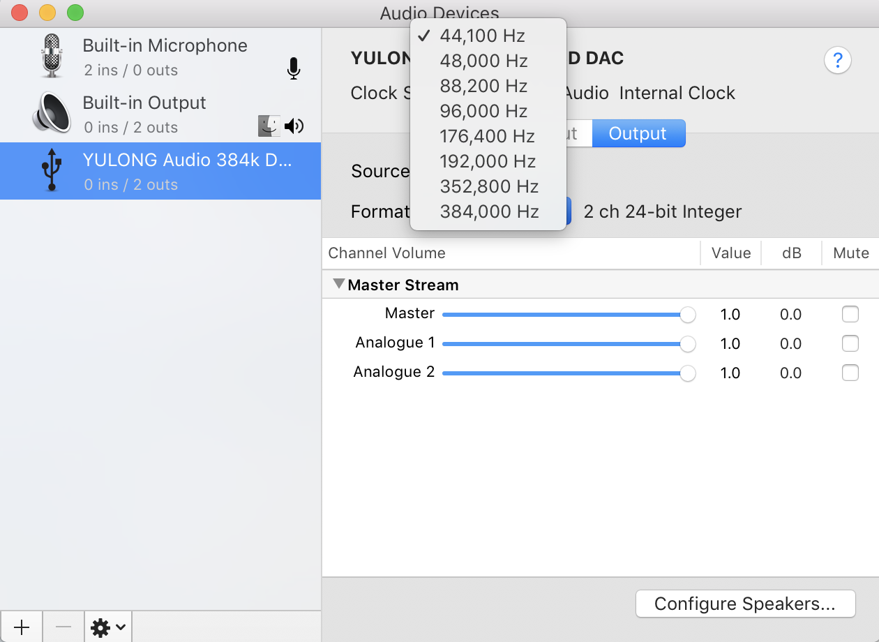

I took a look on the spec of your DAC. My guess is that your DAC may be able to play it, but you may have to config your DAC to accept USB Audio profile 2.0. If that didn't help, it may be because your DAC only accept lower sample rates and then upsamples it to 384k as per the ads.
PS. I usually only play 44.1 or 48 KHz tracks bit-perfectly using 3rd party iTunes plug-in.

Thank you for you're replies. I did not realise that rates above 24/96 do not appear until the DAC is connected and selected. All good now.
