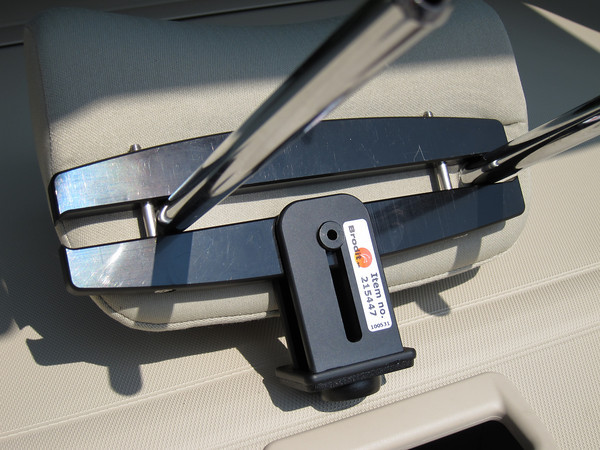

The mount consists of a clamp with a built-in ProClip mounting and a holder for the iPad which attaches to it. The clamp is designed to fit around the posts of a headrest. Unfortunately it didn't fit the headrest in my car, a 2009 Skoda Octavia. The supplied M5 x 45 cap head screws weren't long enough to secure the two halves of the clamp together. They are long enough for a maximum headrest post diameter of ~13mm. The posts in my car are 14mm diameter.
I advised DSL Developments of this and ordered some replacement screws from Service Champions which arrived today. I wasn't sure which length to get so ordered 2 M5 x 55 and 2 M5 x 60 screws. In the end I used the M5 x 55 screws to secure the clamp as shown below:

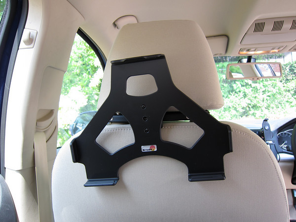

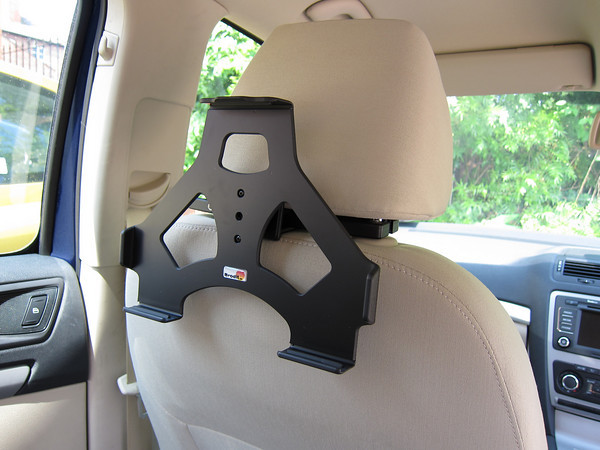

The iPad holder screws to the clamp in the same way as all Brodit ProClip mounts do. It looks like this fitted in place:
The iPad holder can easily be removed by undoing a single retained screw, which is great if you're not going to be using the mount for a while and don't want to advertise you have an iPad.

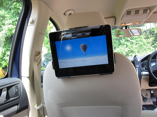

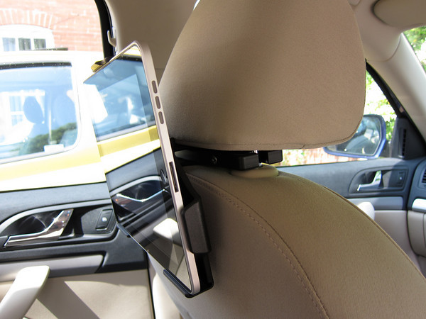

It is very easy to clip the iPad into the holder. It is secured at the top and bottom as shown below. It is important to get the iPad in the right way round so the volume rocker and orientation lock aren't being pressed on.
The wings at the side don't touch the iPad and are only used for location.
As you can see, the holder is great way to use the iPad in a car to keep the little ones in your life entertained. I'm sure my daughter will love watching Peppa Pig and Mickey Mouse on it.

I bought one as well. No scratches. Another option if your headrest bars are too large is to just turn around the part on the opposite side of the headrest. It will work without getting larger bolts.
